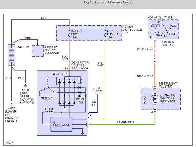

New alt & battery still not charging.
Friday, August 21st, 2009 AT 9:04 AM
14 Replies
BMRFIXIT
  • 19,053 POSTS

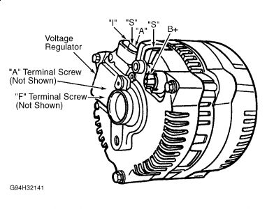

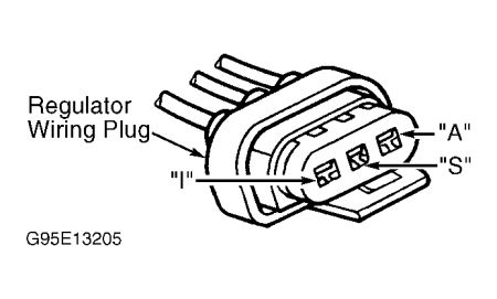

It sounds like you have a fuse out here is a the wiring diagrams to show you what to check for power and which fuses run the system please check it out and get back to us.

Nice! I replaced the STD fuse and the car charges again ya! I love this site.

Turned out to be the connector at the voltage regulator was not making good contact. It's a real crappy connector that ford used forever.
It's been a long time, I think I used a teeny-tiny crescent wrench (i keep in my pocket, along with a miniature channel lock pliers, reversible screwdriver, and pocket knife!). Anyway I slightly bent the terminals down the row, to pressure against the other half. It's sorta obvious, what to do!

Hello, external regulator? Did you check for voltage at the alternator bat terminal, also terminal A at the regulator, where applicable? If nothing there, a problem with the wiring circuit. You need to make sure the battery has a full charge and the cables/wires are clean and tight on both ends.
