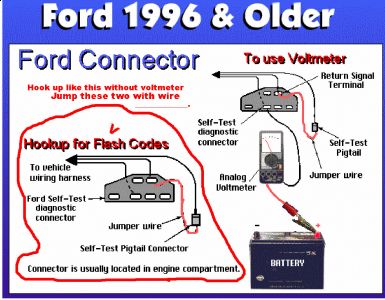

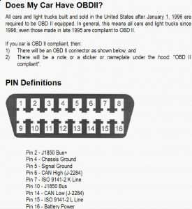

MERLIN2021
  • 17,250 POSTS
On the white label under the hood, it will say EEC IV or EEC V...or tell me what kind of DLC(Data link connector) it has? Under the hood? or under the dash inside the car?
https://www.2carpros.com/forum/automotive_pictures/62217_f_2.jpg
https://www.2carpros.com/forum/automotive_pictures/62217_n_1.jpg
Thursday, April 1st, 2010 AT 3:27 PM

MERLIN2021
  • 17,250 POSTS
This means there is no way to get the codes except to buy a cheap scantool, plug it into this jack and turn the key on, one or more codes should display, write them down and post here. It sounds like a transmission TCC solenoid stuck, but it could also be the filter fell off the pump and is sitting in the bottom of the trans oil pan. BUT it can be other things! Fuel pressure is possible too. Scan first replace parts after! Your DLC is under the glove box.
