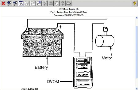

my pass door lock doesn't move up or down. The control for it makes the other 3 doors locks move up and down but not the passenger door.
I removed the panel checked to see if there was anything stopping it from moving and it wasn't then I sprayed the latch with some WD-40 for lubrication and that still didn't work. If anybody has any ideas please let me know.

I suspect the door lock actuator is faulty.
DOOR LOCK ACTUATOR
CAUTION: When performing the following test, use a circuit protected DVOM and do not hold power to solenoid more than 5 seconds.
1. Apply 12 volts to actuator terminals. Actuator solenoid should operate. Actuator rod should complete its travel in less than one second. Reverse leads to actuator solenoid. Solenoid should operate in reverse direction at same speed.
2. Using DVOM, test actuator solenoid draw (stall test). See Fig. 1 . Reverse leads to check reverse draw. Replace solenoid if it does not meet specification.
Draw specification = 6.0 Amps
https://www.2carpros.com/forum/automotive_pictures/192750_DoorLockTest94FordTempo_1.jpg
Fig. 1: Testing Door Lock Solenoid Draw Courtesy of FORD MOTOR CO. ACTUATOR SOLENOID DRAW TEST SPECIFICATIONS
