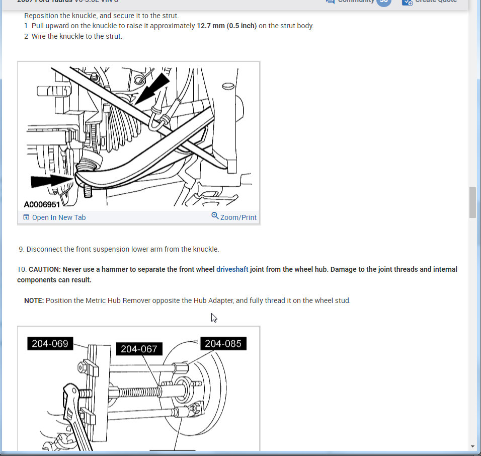

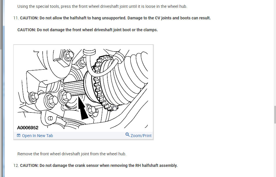

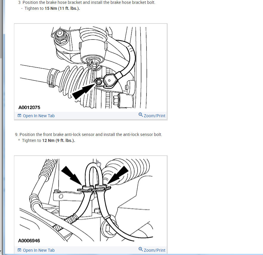

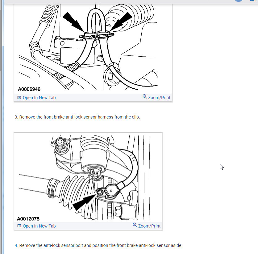

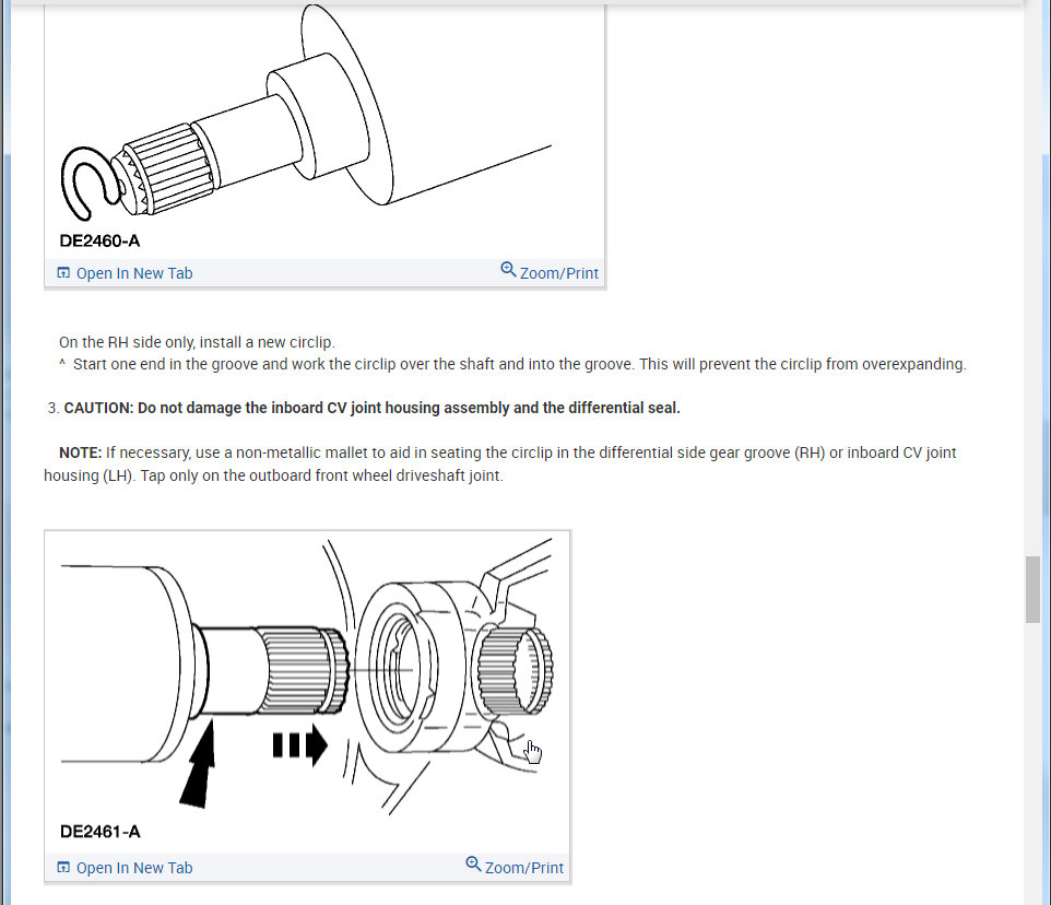

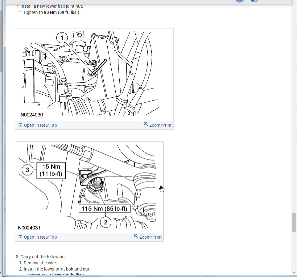

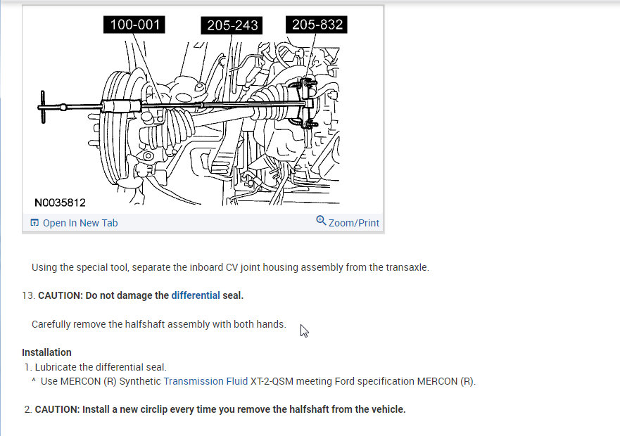

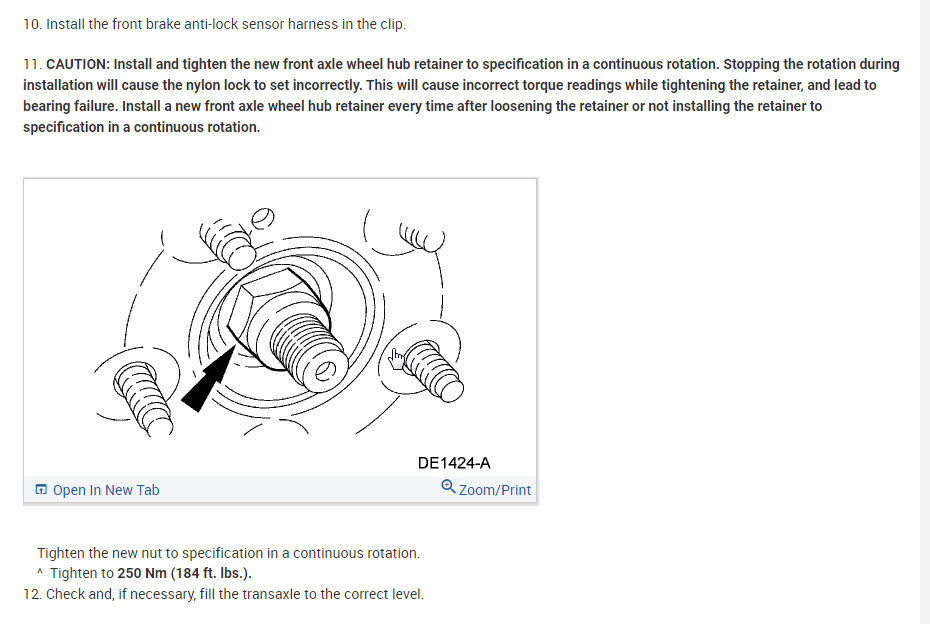

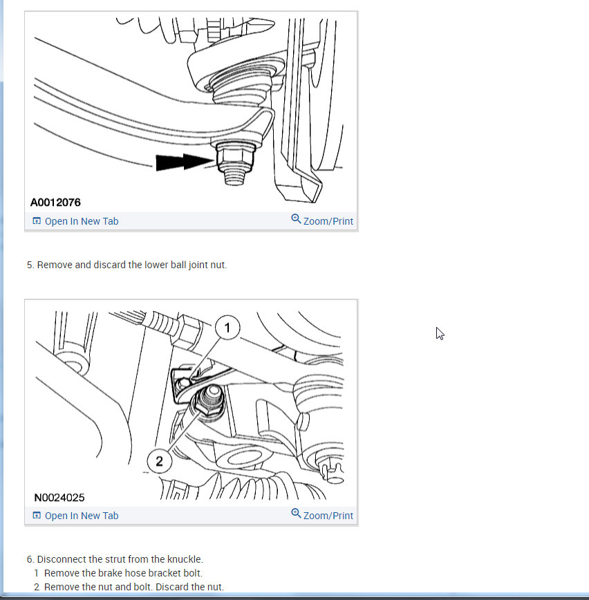

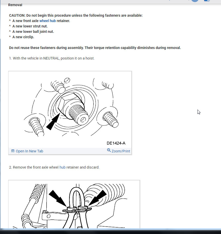

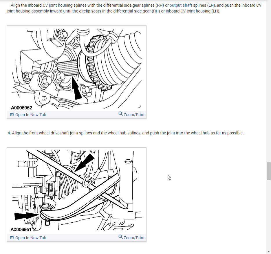

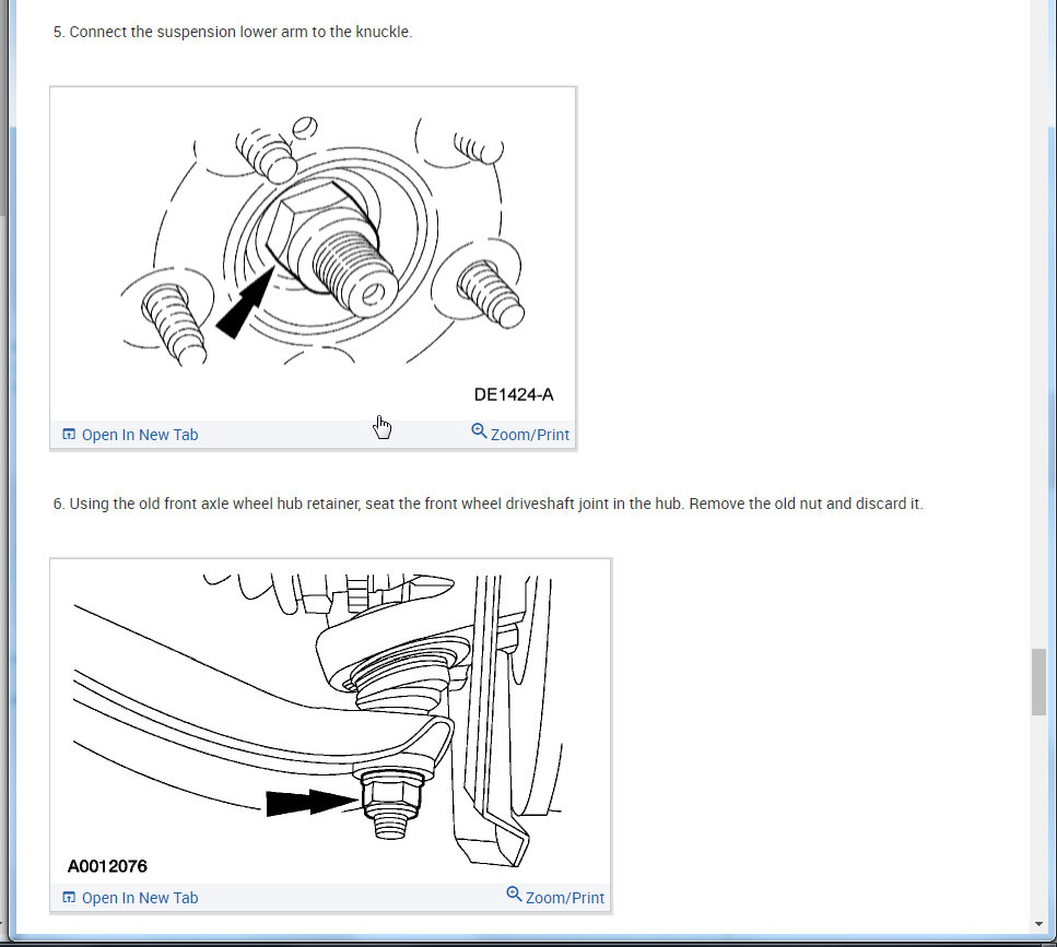

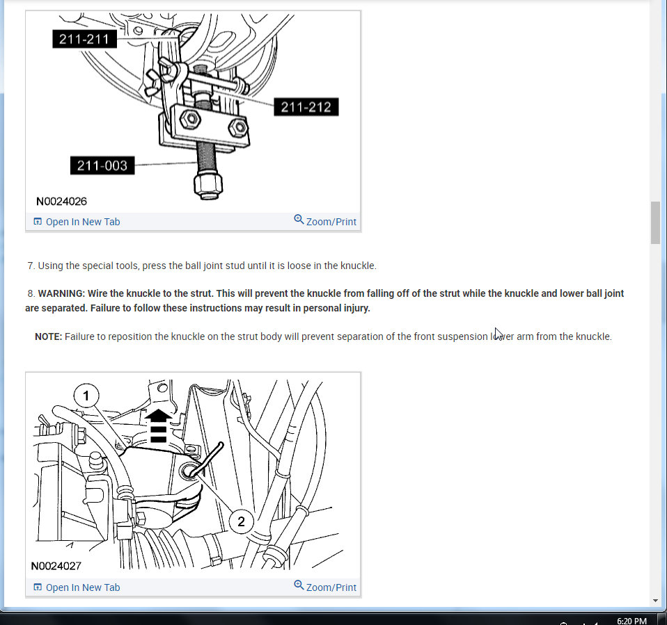

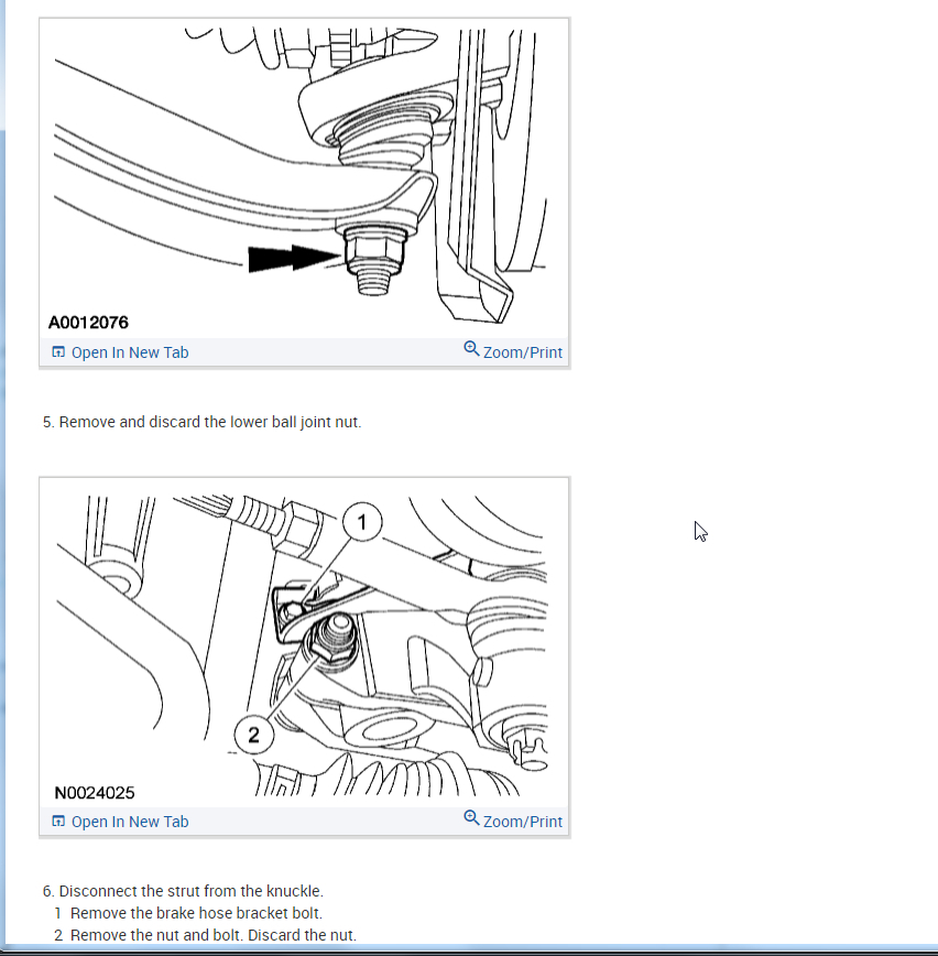

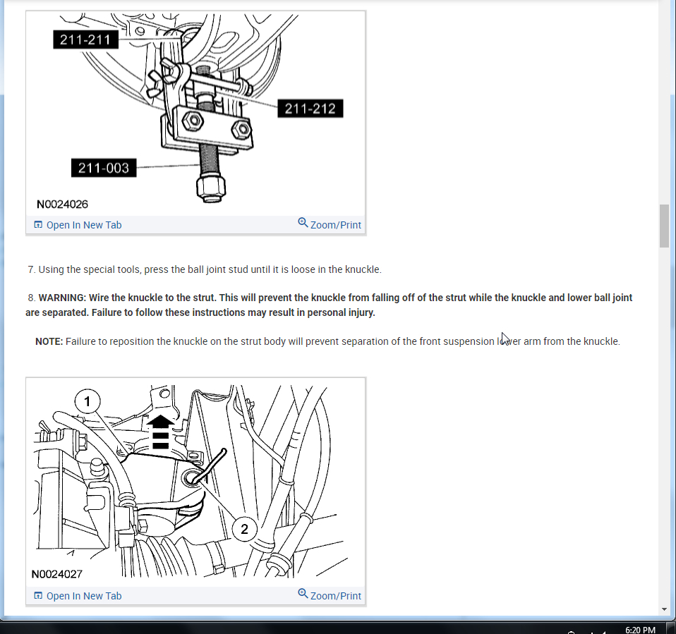

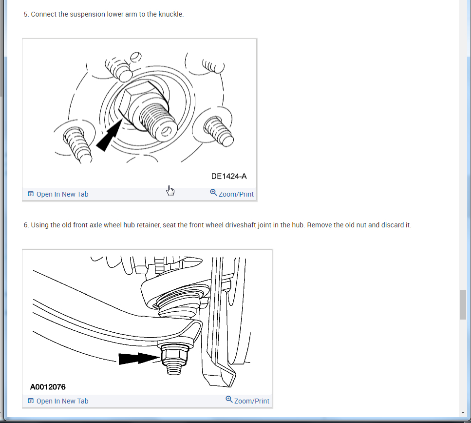

I was wondering how to install a new CV axle for my car?
Sunday, May 30th, 2010 AT 10:54 PM
MECHANIC
18,907 POSTS
Here are some guides on how to replace the axle:
https://www.2carpros.com/articles/replace-cv-axle
https://www.youtube.com/watch?v=XeqT-_fwVQg
Below is the process from the manual on how to replace the halfshaft. Please let us know what questions you have and we can go from there. Thanks
