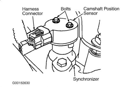

What is a cam synchromizer? And where is it located

Its located below the camshaft position sensor. It is an input to the pcm for timing of when to fire the injectors based on the compression stroke.
