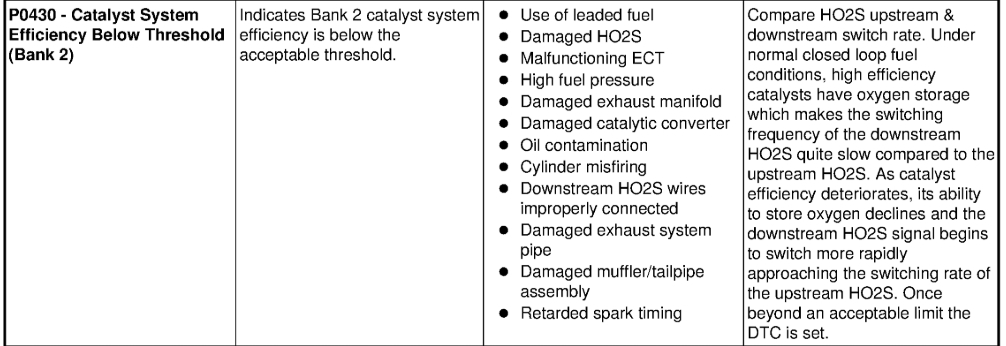

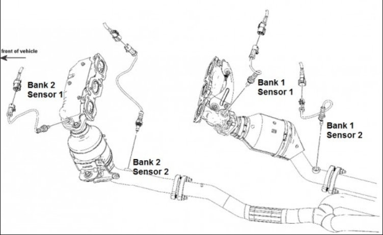

The code P0430 is a code for the bank 2 catalytic converter, so it looks like you have two on your car. I have attached an image of the exhaust system, so you can see where bank 2 is. Simply put, of the two, it is located closer to the tail pipe. I have also attached what exactly can cause your p0430 code to show up.

There are two, one for each bank of cylinders. Direct Trouble Code(DTC) P0430 is bank 2 catalyric converter is not operating within it's efficiency range. Over time your vehicle's catalytic converter will degrade due to normal wear and tear. When the catalytic converter can no longer due it's job, breaking down exhaust gas into harmless H2O and Carbon Dioxide then DTC P0430 will set. The catalytic converter should be replaced.
