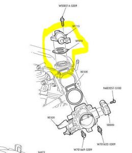

I AM A SINGLE MOTHER OF TWO AND I HAD TO SAVE UP A LOT OF MONEY TO GET THIS CAR NOW WHEN IM DRIVING DOWN THE ROAD NO MATTER WHAT SPEED OR NO MATTER HOW LONG I'VE BEEN DRIVING IT STARTS STALLING LIKE IM RUNNING OUT OF GAS AND IT ONLY DOES IT WHILE IM DRIVING. AND THE OTHER DAY I WENT TO START IT IT WOULD NOT START SO I TRIED AGAIN AND THIS TIME I APPLIED A LITTLE GAS TO IT AND IT STARTED RIGHT UP. AND IT DOES IT OFF AND ON PLEASE HELP ME I DO NOT HAVE MONEY TO POUR INTO THIS CAR I TOOK IT TO A SHOP THAT CHEEKS THINGS FOR FREE AND THE RAN IT THRU A TESTING THING AND SAID THEY COULD NOT FIND ANYTHING WRONG WITH IT PLEASE PLEASE HELP

If it's stalling when coming to a stop
And no codes fuel pressure is good
Remove IAC valve and clean
