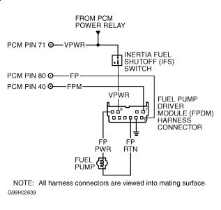

RACEFAN966
  • 5,029 POSTS
Ok now we need to do a couple of tests to see what is going on. First you will need to disconnect the fuel pump driver module (FPDM) with key off and then check with a digital multi meter for voltage between the ground and the power circuit labeled vpwr in the pic with key on engine off. Here is a pic to show you what terms to check power between.
https://www.2carpros.com/forum/automotive_pictures/249564_Graphic_98.jpg
