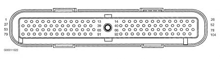

Ok now if the sensors are off in gap or anything that may change the expected reading of them it will also set that code. What I am saying is that the computer is set with what the sensors should be reading and if between the two they do not agree with what the computer know's to be right then the code is back. So lets see if it is a sensor or the PCM let not just jump to it I don't sell that many at work. So with that you need to use you Digital Multi Meter and measure voltage. you need to disconnect the harness to it and with the key on engine off check voltage between the harness and the neg side of the battery if it is 10.5 volts or better then you will do the next step, which is to turn key off and check for voltage between the connector and the pos. side of battery if 10.5 volts or better then let me know and we will go to the next step. What we are testing is weather or not there is an open circuit. So here is the plug diagram so you know what is poss. or neg on the plug.
The first step is checking that the sensor is getting voltage so you do it on the batt side of the connector the second is checking the ground side, does this make sense? here is the diag op the plug

Now with key off diconnect the pcm connector make sure the cam possition sensor it pluged in good and between cam sensor and power ground circuit at the pcm connector set volts to 20 dc crank engine over at least 10 revolutions (engine will not start) voltage should switch from 2 to 8 volts if so pcm is bad it not then you got a bad sensor. So possitive from multi meter goes to term. 85 and the ground to term 103. Here is a pic of the connector and how the terms are numbered.

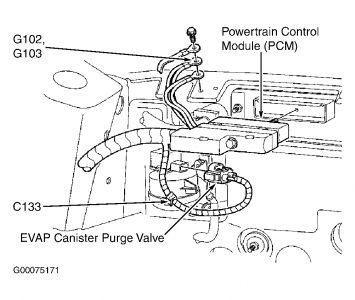

Could you tell me where the power control module is located on the 03 Ford Taurus?

First you told me it was code p1336 not 1136 and yes check the cam sensor they work together as for the pcm connector it is on the right rear corner of the engine compartment mounted on the firewall.
https://www.2carpros.com/forum/automotive_pictures/249564_pcm_1.jpg
