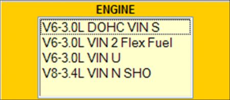

So we are on the same page here - first from the pic below - tell me the engine you have in your car and the 8th digit of your VIN number.
http://www.2carpros.com/forum/automotive_pictures/248015_Picture10_3.jpg

The engine of the car and the 8th digit of VIN are :
V6 3.0L VIN U

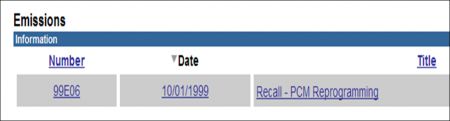

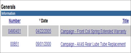

This is most important. It looks like you may have some recalls on your vehicle. The dealer may fix these for free. Please contact the dealer service department, give them the VIN number of your car and have them check on these to see if they apply to you.
http://www.2carpros.com/forum/automotive_pictures/248015_Picture13_3.jpg
http://www.2carpros.com/forum/automotive_pictures/248015_Picture14_3.jpg
http://www.2carpros.com/forum/automotive_pictures/248015_Picture15_2.jpg

PS : You asked me to see if there was a recall for my car. I went on the ford web site, put the car VIN and it told me there was no recall on this car.
Friday, November 21st, 2008 AT 9:05 PM
IMPALASS
  • 3,112 POSTS
Hello -
That is fantastic if the fluid level being too high is your problem. Some transmissions are very sensitive and must be exact. Lord willing this is your problem.
As for the recalls, I didn't ask you to see if there were any recalls on your car...I attached them to the post for you. My suggestion was for you to take the ones I gave you and call the dealer service department and see if any of them apply to you. Good idea though checking the web!

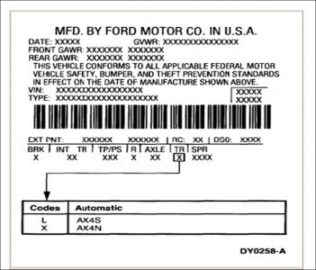

I wanted to by a new VSS at AZ but they asked me for my transmission type : AX4N or AX4S. I couldn't say so I did not by the VSS.
Please tell me how I can identify my transmission.
Thanks

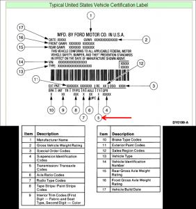

Well, sorry that didn't work. . ..but, please recheck the fluid level per the previous instructions just to make sure it is at the correct level.
Next, I have attached the label and the code for the lable. It is number 5 where the red arrow is pointing. The Vehicle Certification Label (VC Label) should be affixed on the LH front door jamb.
http://www.2carpros.com/forum/automotive_pictures/248015_Label_with_arrow_1.jpg
http://www.2carpros.com/forum/automotive_pictures/248015_label_2_1.jpg
