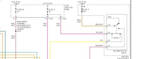

Ok well how bout this question. My heater stays on sometimes when I turn the car off. Well I should say the fans. Sometimes ill turn my car off and take the key out and the fans will keep going. I have full control over the dials. If I turn it to defrost, it goes there. If I change it from high to low, it does it. The only difference is that if I change the dial to off, it blows out the floor vents. No idea on this one

Hi, did you ever talk to Kenwood about your radio, if not, why not? Just curious?
If the blower motor relay isn't energized, the blower motor shouldn't work. Voltage feed to coil side of relay, comes from ignition switch.
https://www.2carpros.com/forum/automotive_pictures/170934_taurus_blower_motor_1.jpg

Ive called Kenwood before about this problem and they told me they didnt know what to do. The heater problem probably is the wiring.
