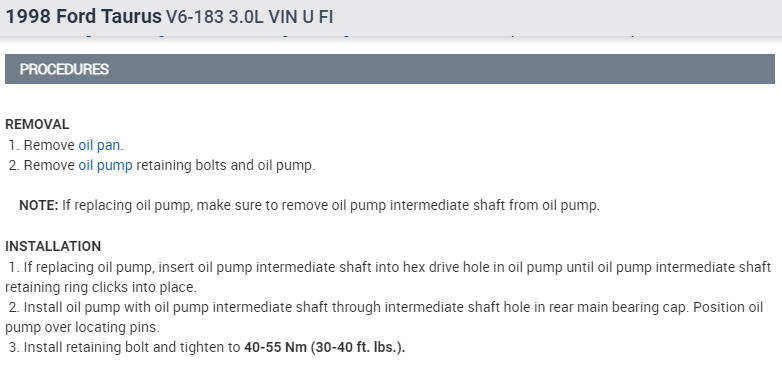

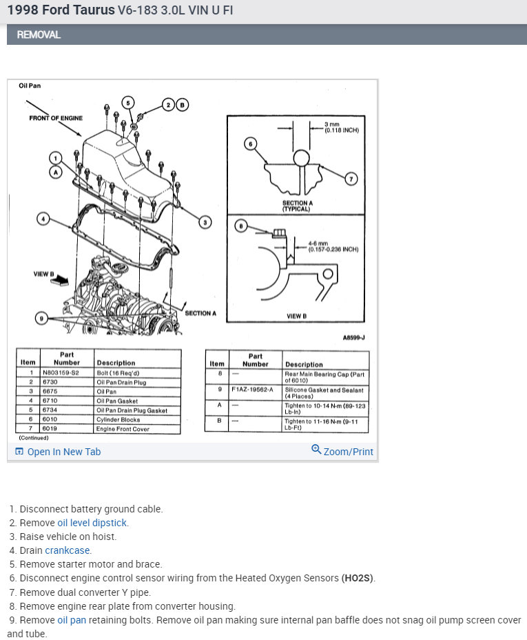

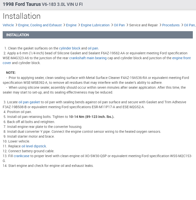

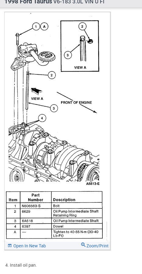

SHINE TWUZTID
I'm asking about my car through this question because it is exactly what is going on with mine now.
I replaced the switch already and there never was any light to begin with but, there is tapping, and I know there is no oil on the heads because when I put oil onto them, they quieted right down.
So, would I need to replace the pump since the sensor/switch is good?
Friday, October 22nd, 2021 AT 1:18 PM
SQM
  • 6,383 POSTS
Best course of action would be to test the oil pressure. This way you will know if the pressure is insufficient.
You can install an oil pressure gauge to the same spot where the sensor is.
This vehicle should have 40-60 PSI of oil pressure at 2,500 RPMs.
