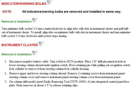

How do I change the dash lights?

https://www.2carpros.com/forum/automotive_pictures/261618_Noname_1080.jpg
https://www.2carpros.com/forum/automotive_pictures/261618_Noname2_310.jpg
