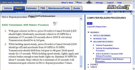

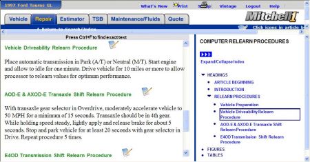

What is the speed range range before it goes high? You sure the transmission is not slipping in/out Hook up a fuel pressure gauge and monitor the fuel pressure before it goes high.
BTW at anytime did you disconnect the battery while replacing parts
Lets try the relearning process below and also select your type of tranny If it doesn't work-Get the computer tested
http://www.2carpros.com/forum/automotive_pictures/12900_r1_5.jpg
http://www.2carpros.com/forum/automotive_pictures/12900_r2_5.jpg
Tuesday, March 30th, 2010 AT 12:55 AM

Ok did that resetting as directed on the last post (Thanks). This happens at speeds above 20 MPH. It is still doing it and the Transmission isn't slipping. I feel like I can't win with this one?
Thanks for all of your help, I'll keep trying :-)
