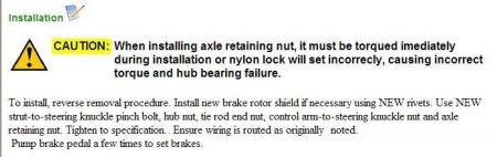

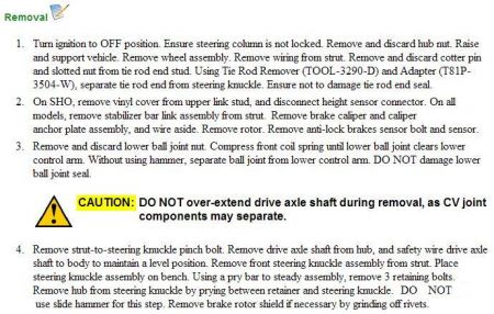

im in a jam with the extraction of my lower drivers side ball joint on my 97 taurus ive gotten the ball joint out of the lower control arm but I cant seem to find out how to get the drive shaft outta the way to remove the joint out of the knuckle it has anti lock brakes and the mechanism is blocking me from removin the three screws holdin on the hub assembly. Please help im losin precious hair over this.

https://www.2carpros.com/forum/automotive_pictures/261618_Noname_1398.jpg
https://www.2carpros.com/forum/automotive_pictures/261618_Noname2_413.jpg
