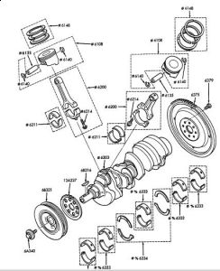

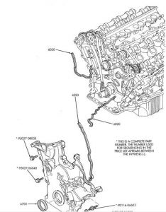

I went out to start my car and it wont turn over thought it was starter but that is good next I thought motor was sized up so I put a braker bar on crank now her is what I need a answer on I can turn the motor over counter clck wise as many time around as I want with no problem but it will not turn clock wise at all I took valve covers off and all 4 cams are turning like they should oil pan is off everything looks good there also

Remove oil pan and check for failure
Sunday, February 28th, 2010 AT 7:31 AM
SCOTT3077
  • 8 POSTS
Oil pan is off everything looks good
Sunday, February 28th, 2010 AT 12:24 PM
BMRFIXIT
  • 19,053 POSTS
https://www.2carpros.com/forum/automotive_pictures/99387_Noname_5.jpg
https://www.2carpros.com/forum/automotive_pictures/99387_fan_36.jpg
Remove spark plugs and turn the crank
looking for any broken parts
Sunday, February 28th, 2010 AT 7:13 PM
