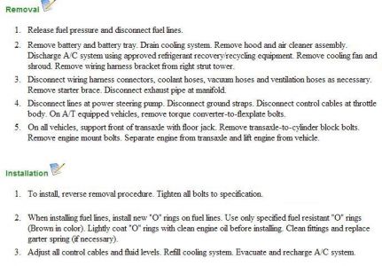

Hello, I have a 1994 taurus going to be swapping an engine. I have the ford service manual they want you to pull half shafts and drop the whole assembly with sub-frame. Unfortunately I do not have a hoist to do that. I was wondering if the engine can be taken out through the top.
It's a 1994 taurus 3.0L Vulcan (12v)
thanks in advance!

You shouldn't have to use a hoist to replace your vehicle's motor. Try the following operations..
https://www.2carpros.com/forum/automotive_pictures/261618_Noname_701.jpg
