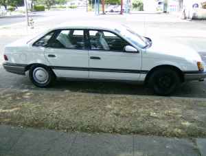

why do i have to turn my ac on to make the fan work on my car

That would indicate a faulty coolant temperature switch, not sending unit.
Ground the switch out on the Postive battery terminal with key on, does fans turn on? If not could be a relay or bad wiring.

How much will that cost to fix that sensor/switch?

Dunno what they will charge for the switch.
The labor will take no more then 30 mins.

Where can you buy those sensors, and tell me is this what they look like,

You can get a switch for 14 bucks on partstrain. Com
just search for your year, make model
then coolant temp switch NOT sensor.
