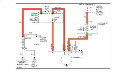

My battery light keeps coming on and low battery indicator keeps coming on while I'm driving. I took it in and had the battery, alternator, and starter checked and they said it didn't show any problems but the light only comes on when I'm driving, so they said it wouldn't tell them anything unless the light was on. It doesn't come on when I'm coasting or idling and it starts right up.
May 12, 2025 at 8:48 AM (Merged)
  • CAR REPAIR CONTRIBUTOR
  • 75,992 POSTS
Check and test the ALT fuse 30amp and fuse no.15 7.5 amp and wiring to and from the alternator, also belt tension.

I have a 1996 Ranger with a consistent battery drain. I have ruled out both the battery (by replacing multiple batteries) and the alternator (by having tested). Here is what I have observed so far. When I place an ammeter in line with the neg battery terminal and neg battery post, with the doors all closed, and before the GEM shuts down, I am showing .23 amps. When the GEM shuts down after 40 minutes or so, the current reading goes down to .15 amps. Now I start pulling fuses. (I use a screwdriver to close the door latch so I can get at the fuse box with the door open.) When I come to the large fuse in the main fuse box under the hood labled FUEL SYSTEM / ANTI THEFT SYSTEM and pull it, the current reading goes down to .05 amps (which is considered normal by ford standards). I have read that there is a TSB from ford regarding fuel pump and ecm relays sticking and causing a batery drain, so I replaced these relays, with no luck. I can't hear the fuel pump running, nor does there seem to be any problems with my factory antitheft, although I have no idea where the module is to disconnect it. One thing i did notice is that my gas gauge stays put (energized?) with the ignition off. I have no idea what else to check. Someone please help before I pull out all of my hair.

BUDDYCRAIGG
  • 2,262 POSTS
I'm looking at your schematic.
and fuse #12, a 20 amp MAXI fuse
goes straight to the fuel pump relay.
If you unplug the relay and the draw is still there, then it has to be the RAP module.
There is only one connection between the fuse box and the RAP, and that is directly at the RAP (C409). so I would assume that it has to be close to the fuse box.
I'll keep looking for a location for you.

RESQ12345
I found the RAP module and disconnected it and the current draw went away. My question is: what SHOULD be the correct current draw? I have had no problem with the anti theft system. Also, could a remote relay be causing the drain? I would prefer to replace a relay first before replacing the RAP
