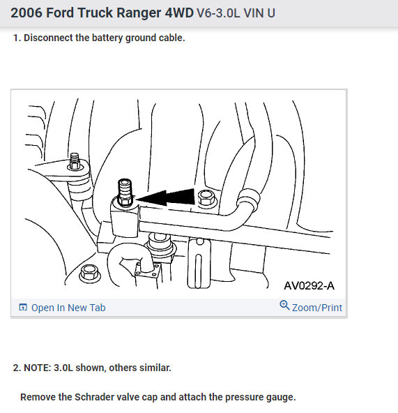

I am trying to replace my fuel filter

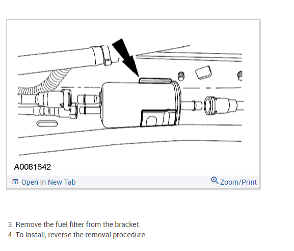

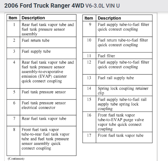

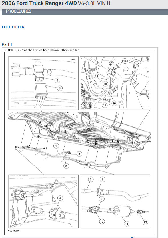

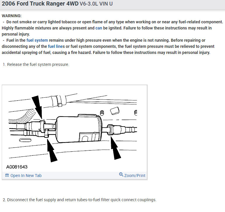

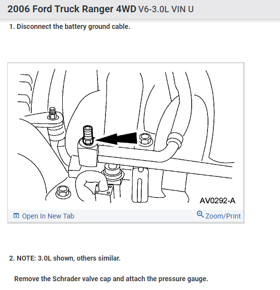

Replacing the fuel filter on this truck can be done easily.
Depending on the style of the clips you might need a quick disconnect tool to get the lines off the filter. Those tools are typically available at your local auto parts store.

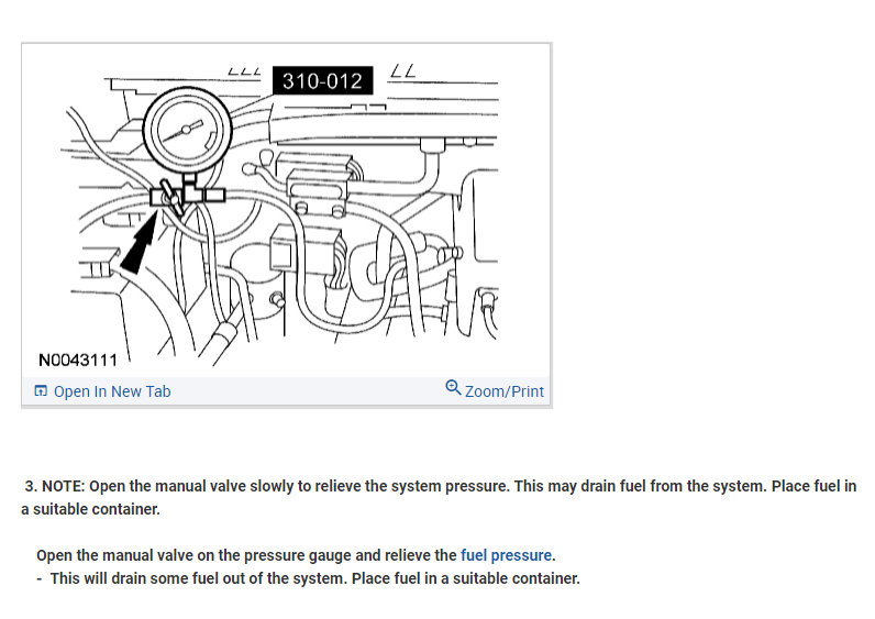

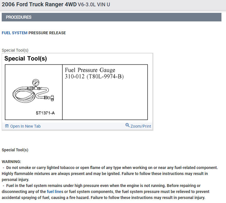

It is also a good idea to release the fuel pressure before disconnecting the fuel filter (instruction attached).
https://www.2carpros.com/articles/how-to-change-a-fuel-filter
I have attached the diagrams for the fuel filter replacement below.
