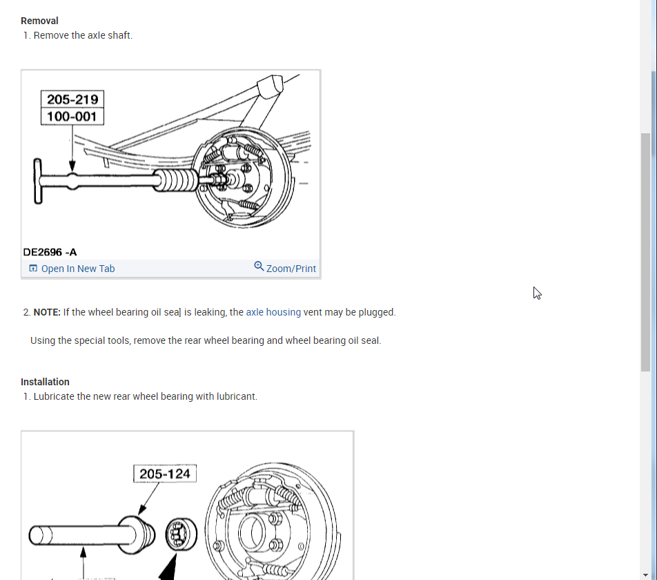

I went and got an oil change today, and they told me that my rear axle bearing was bad.
Wednesday, January 16th, 2008 AT 10:27 PM
MECHANIC
18,907 POSTS

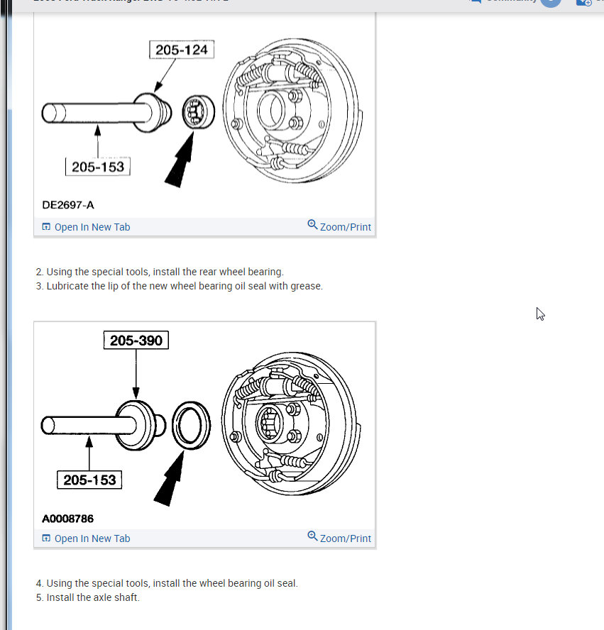

Here is a guide that will help with step by step instructions:
https://www.2carpros.com/articles/bearing-hub-replacement
Also, below you will find the process from the manual that will help give the specific info that you need to accomplish this.
Please let us know if you have other questions. Thanks
