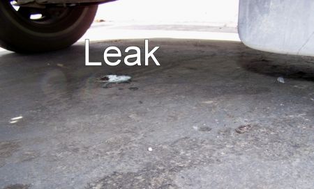

Recently, I noticed that my overflow reservoir was a couple of inches below "min". I brought it up to "min". It appears that since then - when I stop the truck and park - I will see a couple of drops of what appears to be coolant on the ground. The drops are not warm or hot - they feel like ambient temperature. After a couple of days - the reservoir is back to slightly below "min" and I did not notice any drips today. The drips are not where I would normally expect to see the A/C condensation drips. I would assume that any relevant drips after 30 minutes of running should be warm? The color is between clear and orange/yellow - which appears to be close to the color in my reservoir. The drips are approx. In the middle of the front of the truck approximately 2 feet from the front and mostly centered across the front. I never noticed this problem until I brought the reservoir back to "min". Thank you.

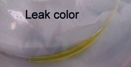

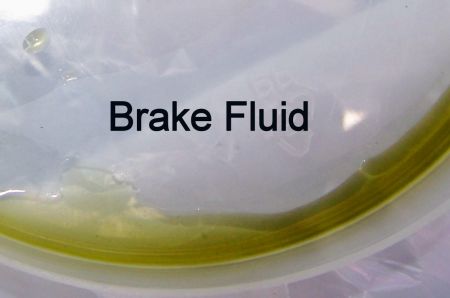

Thank you for your help. I don't see any hose leakage from what I can see. I am going to get someone more mechanically qualified to look into the other areas. I have attached pictures of the leak and its color. I also took pictures of my brake fluid and radiator reservoir fluid color. They both look very close to the leak color. After driving the truck for 20 minutes today - I put my hand where the drips were going and the temperature was ambient - not warm or hot. But as you said the drips probably hit other metal and cooled sufficiently before hitting the ground. I did check my oil today and the color was normal and not milky as I have read would be a symptom of the coolant getting into the engine oil. Anyway, I will take the truck where I can get an estimate of what is causing this leak. Thanks again.

I brought the Ranger to a shop. They found the heater control valve to be bad. They replaced it and pressure tested the truck. They say the leak is gone.
