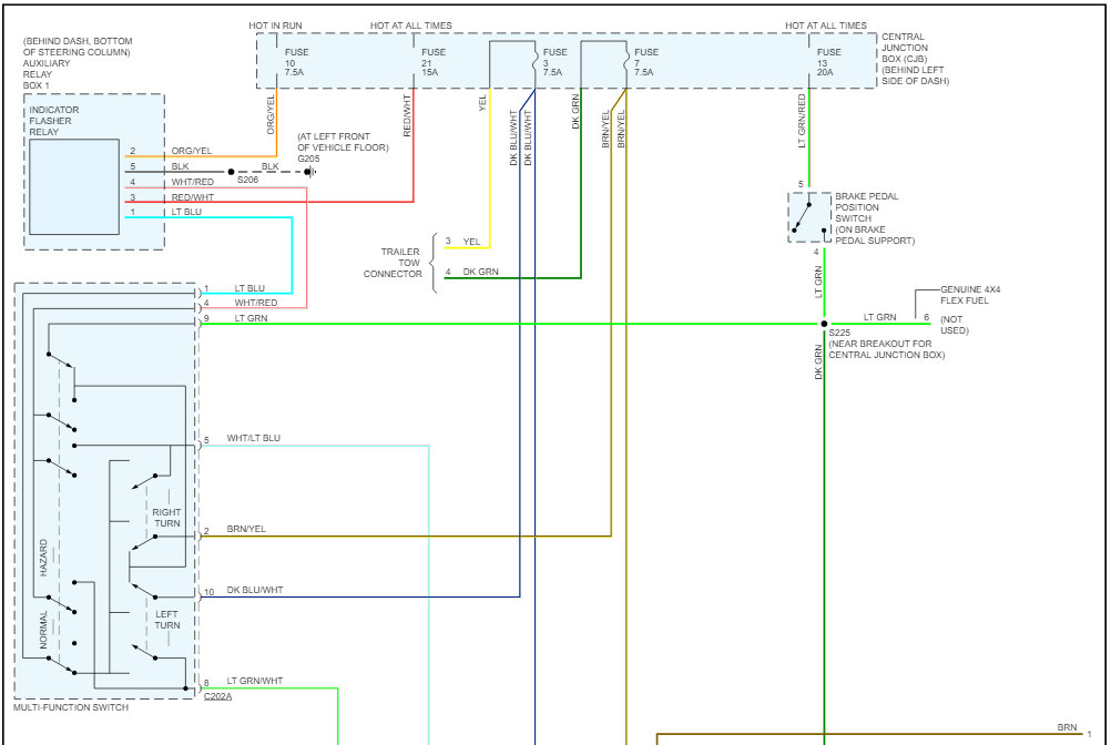

brake lights are not working He has replace the brake on/off switch and checked all the fuses
2003 FORD RANGER
79,000 MILES • 6 CYL • 2WD • AUTOMATIC
MEUJAKEMMY
My husband's 2003 Ford Ranger's brake lights are not working He has replace the brake on/off switch and checked all the fuses. And also has tried changeing the bulbs with no sucess of fixing the problem. Can you help us?
Jan 27, 2009 at 11:07 AM
SQM
  • CAR REPAIR CONTRIBUTOR
  • 6,383 POSTS

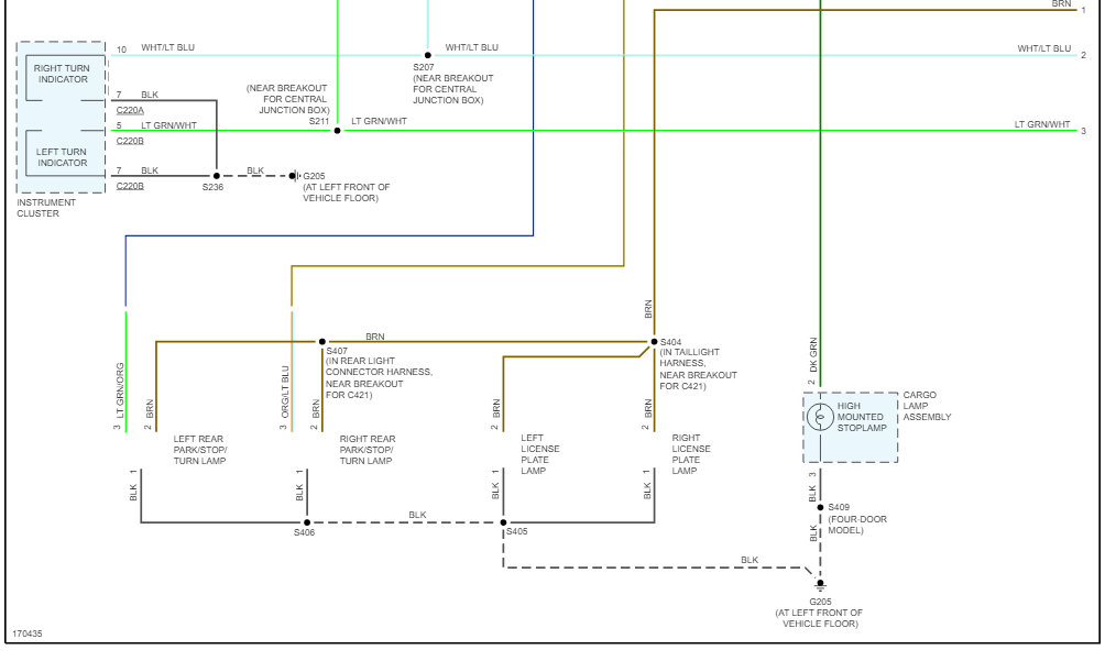

This sounds like a wiring issue. Likely bad ground.
The ground connection on these vehicles can corrode and the lights will not function.
Here is a helpful guide on how to check wiring:
I have attached the wiring schematics for the lights for your reference.
