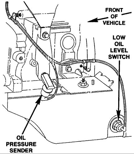

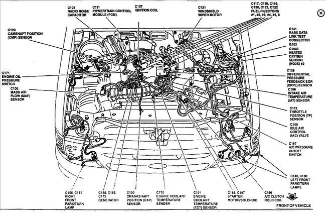

I have what appears to be an oil pressure gauge that is not functioning. I purchased a new oil pressure sending unit in hopes that it will fix the gauge issue. The problem is that I have no clue where the old one in in the engine compartment. I stopped at a Valvoline Quick Oil Change hoping they could help to locate it but they could not. Any place I could find an illustration that would point out the unit in my pickup?
Thursday, March 25th, 2010 AT 8:10 PM
18 Replies
KEN L
  • MASTER CERTIFIED MECHANIC
  • 55,469 POSTS

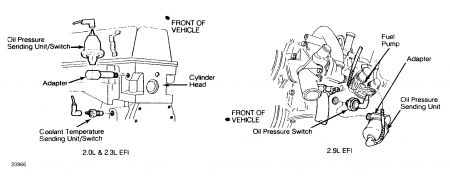

The oil pressure sender is near the oil filter. Here are some diagrams that will show you where the sender is on both 6 and 4 cylinder engines. (Below)

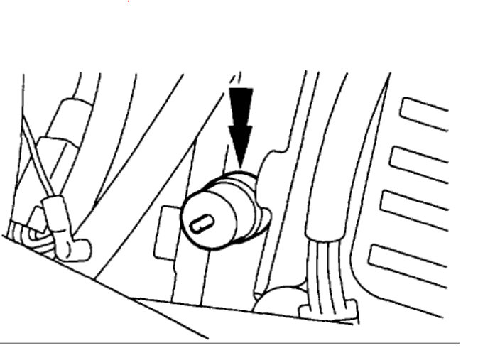

How do you replace a oil pressure sending unit, where is it located? Thanks
Monday, December 7th, 2020 AT 8:29 AM (Merged)
  • 75,992 POSTS
3.0L engine its located on right rear of engine
4.0L " " " " lower left front of engine.

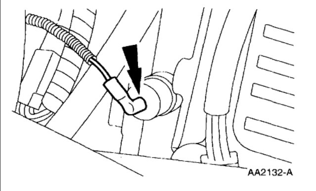

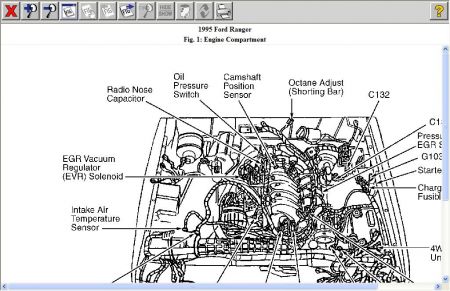

Where is the oil pressure sensor location
Monday, December 7th, 2020 AT 8:30 AM (Merged)
  • 75,992 POSTS
Its located on right rear of engine-see below

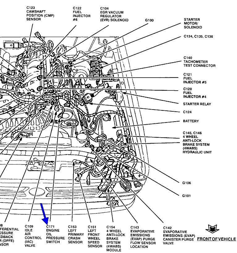

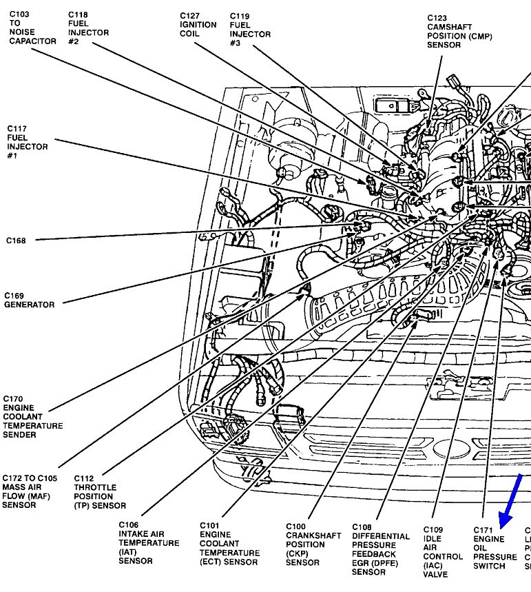

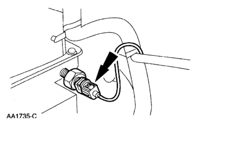

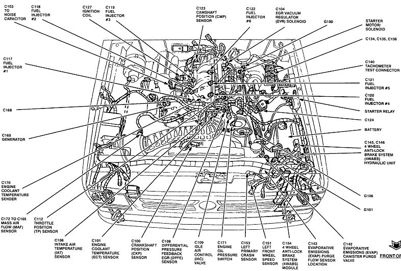

I need to know where the oil pressure switch is at on the truck listed above. Also it's not in the front, where all the diagrams say it is. Also it's a manual transmission if that has anything to do with the location of the oil pressure switch.
CARADIODOC
  • 34,489 POSTS
The blue arrows are pointing to it. The first and fourth drawings are the two parts of component layout under the hood. The second and third are just expanded views if the first drawing to make it easier to read.
-1

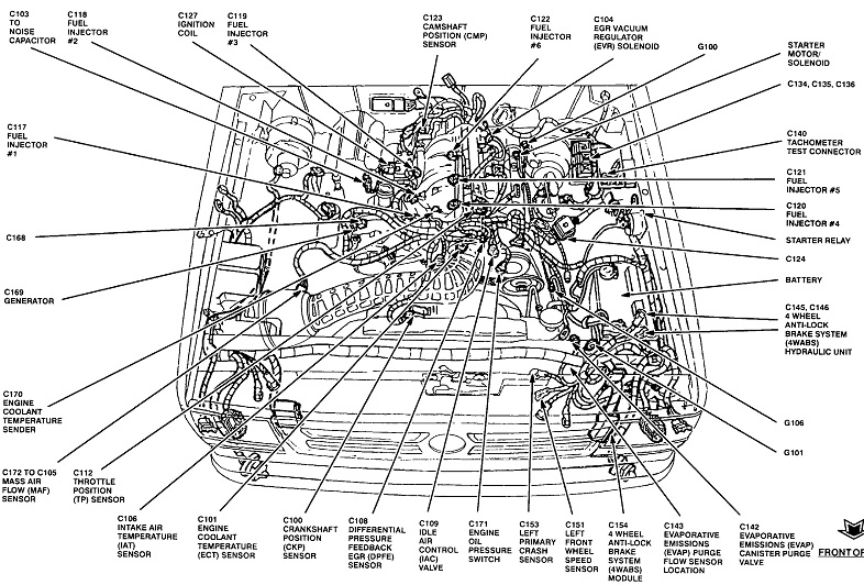

CARADIODOC
  • 34,489 POSTS
"On the fourth picture where is the oil pressure switch because I think that diagram is the right on but it doesn't label the oil pressure switch.".
The fourth diagram isn't involved with your request. I just included it so you would have everything available for your truck. The sending unit is shown on the first drawing, but it's hard to read. That's why I cut it in half so it could be expanded. That's the second and third drawings, and those are where I added the blue arrows at the bottom.

I need help with changing oil sending unit I cant find it on the block
BMRFIXIT
  • 19,053 POSTS
Oil pressure switch
3.0L on right rear of engine
4.0 L on lower left front of engine
