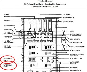

I've had this 98 Ford Ranger for about a month. The wipers do not work in the morning but will work in the afternoon and evening. Engine temperature doesn't seem to have much to do with it.
I've already installed a new multi-function switch, and I've replaced the fuses in the interior fuse box.
I have no other electrical problems to report. All the other signals, etc. Seem to be normal.
Is there a relay somewhere that I'm missing? What else can it be?

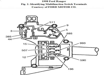

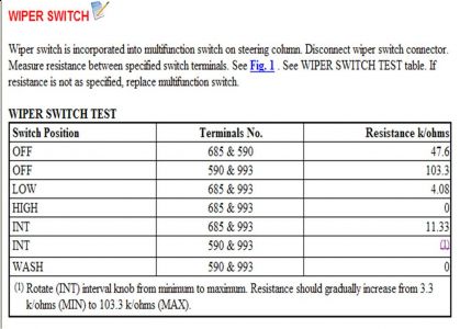

I know you just replaced the switch but by chance there may be a bad wire. . .. . .. . .here is the tests for the switch.
https://www.2carpros.com/forum/automotive_pictures/248015_Picture1_84.jpg
https://www.2carpros.com/forum/automotive_pictures/248015_Fig_1_7.jpg

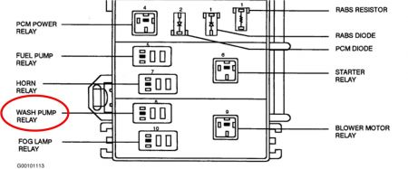

You have 3 relays. . .. . .. . .. . ..please test each one. The wiper high/low relay, wiper run/park relay or washer pump relay. I have attached the pic of the location of the relays. . .. . .. . .for ease of viewing it is in two parts though. . .. . .. . .. . ..so make sure you overlap.
https://www.2carpros.com/forum/automotive_pictures/248015_F2_6.jpg
https://www.2carpros.com/forum/automotive_pictures/248015_F7a_1.jpg
https://www.2carpros.com/forum/automotive_pictures/248015_F7b_1.jpg
I will continue to look for any tests for the CTM while you are doing the above. . .. . ..is that okay?

If it were me I would first do the tests I suggested above....... Going to AZ or OR for codes, the other tests on the motor and relays.
I suggest this as the relays may be getting worn or defective. The motor may have dead spots in it and that may give us a clue.

Well,
Not having confidence in my abilities to do diagnostic work with a jumper lead (and not having a jumper lead around), I took the truck in to a nearby Ford Dealership. They did a recall repair and for $96, were able to tell me that all the relays and switches were fine, and that when they tap on the motor, the wipers come on. So there's something internal to the motor.
They then offered to replace it for me for $420. I'm going to pick up a rebuilt motor from O'Reilly's for $60 and attach it myself. That should do it.
Thanks for your help. If I had any experience with the jumper lead, you would have been all that I needed to get this one solved. I'll be back next time.

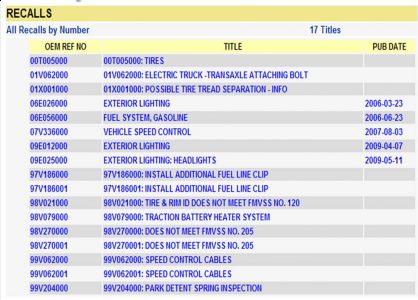

Hey, one other thing. it also, it looks like you may have some recalls on your vehicle. The dealer may fix these for free. Please contact the dealer service department, give them the VIN number of your car and have them check on these to see if they apply to you.
https://www.2carpros.com/forum/automotive_pictures/248015_Recall_21.jpg

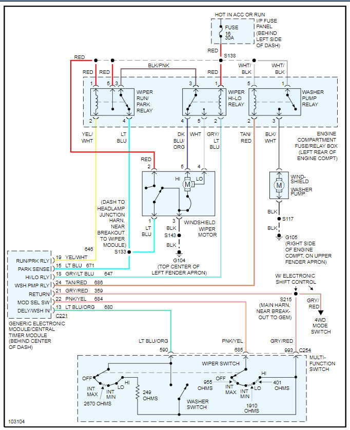

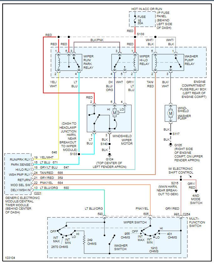

It does sound like a control module issue so let's assume that and try to prove it. Here is a wiring diagram that we need to monitor voltage on.
Basically you have a hi/lo relay and a park run relay. When you turn the switch to tell the GEM to turn the wipers on, it uses the run/park relay to determine if they are moving or not. Then it puts the hi/lo relay in the position of the switch. It defaults to high so when you turn the switch to lo it turns the relay on and it moves it to apply power to the low side of the motor. Then it turns the relay off when it is on hi. So if you are on hi, you should have no voltage from the GEM to this relay.
Let's turn the wipers on low and check voltage at the GEM on the two wires coming from the switch. Then check voltage going to each of the relays at the GEM. The GEM is actually supplying the ground to complete the circuit on these relays but you should have voltage on both when on Lo.
Here is a guide that will help with this:
https://youtu.be/Hlna_kUt7As
Below is the diagram for your use. Let us know what you find.
