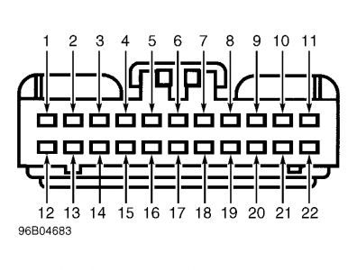

Ok first gain access to the GEM and use the pic below to do a couple of tests. We are going to check the white wire with the light blue stripe on it. Now unplug the C3 connector from the gem and check the resistance of this wire between the 4x4 switch and the GEM term number 8, it should be less then 5 ohms if more then check for a break in the wire. Now plug it back in and do a voltage test between the white wire with the light blue stripe and gray wire with the red stripe. Should be battery voltage with key on engine off, if not look for a short in one of the wires. Now unplug the C3 connector again and check for continuity between ground and the white wire with the light blue stripe, if continuity is pressent then look for the short or where it is touching ground, if no continuity then we go to the next test on the GEM. You will need to be a little patient as this is long test. Get back to me with what you find here and we will go to the next step from there..
RESULT: NO discernable continuity
RESULT: Found two grey wires no red stripe on either, but by working at corresponding grey/red wire at switch switch figured out which was switch leg. Only found 3.7 volts with key on (Car not on).
RESULT:Key off: 4.17 K ohms
Key on: 5.80 K ohms
NO PROBLEM! PATIENCE I GOT-- EXPERIENCE AND SPECS I DON'T!
Talk to you soon.
Brad Chute
Saturday, October 24th, 2009 AT 9:07 AM
RACEFAN966
  • 5,029 POSTS
Ok check that gray wire with only 3.7 volts for any fraying or breaks as it sould be battery voltage. Let me know if you find anything and we will go from there.

There is 12.0 (a little less that batt voltage) at grey terminal harness side (#14) on GEM.
Also, when brake is depressed with engine running there is about 11.6 next terminal over so it seems like GEM is getting that signal.
The selector switch is only receiving 3.4 volts from the GEM.
When HI is selected the voltage drops to 2.4
When LO is selected it goes to 1.2v
The voltage remains at 0 at two other wires (red/blk stripe and green/red stripe) throughout.
I tried supplying 12v to white/blue stripe connector on switch (feed from GEM) and provided good ground to solid black at switch. No lights, no shifting.
Talk to ya soon.
Saturday, October 24th, 2009 AT 2:43 PM
RACEFAN966
  • 5,029 POSTS
Sound like the GEM is not sending the signal for the 4x4. Before we say it needs to be replaced I would like to check the transfer case relay module. Use the pic below for reference. Now with key off disconnect the transer case relay module. CHeck for continuity between term 8 and 1. If there is continuity then the transfer case relay is the problem and needs to be replaced. Unfortunitly it don't tell me where it is. Here is the pic of the connector.
