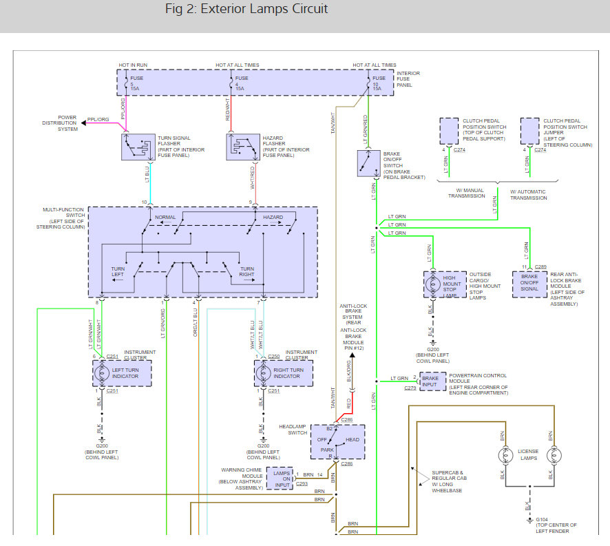

I was wondering what would cause my turn signals to not work but my hazards work

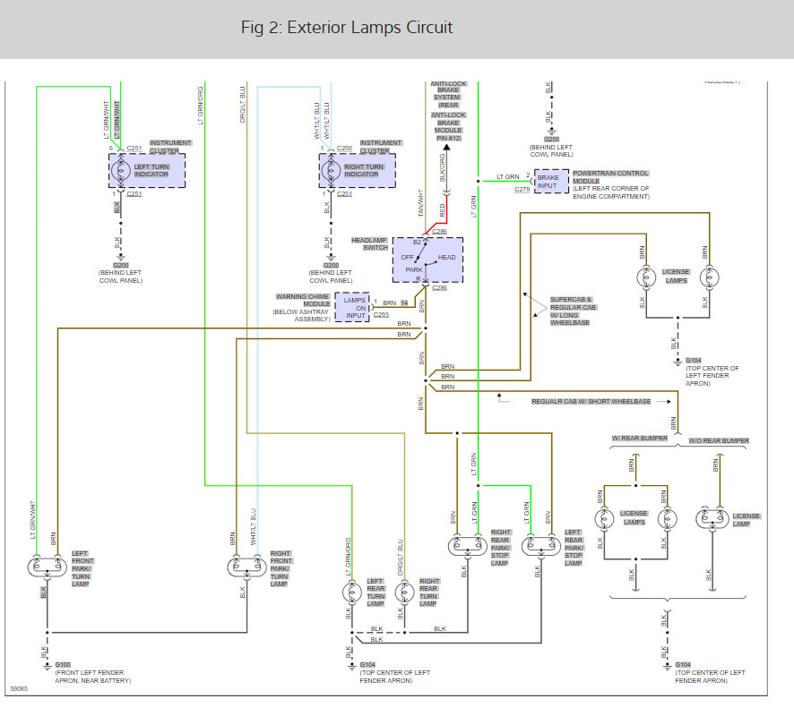

It sounds like it might be the hazard switch here is a guide to help you test along with the blinker wiring diagrams so you can see how it works.
See where you are losing power. Check out the diagrams (Below). Please let us know what you find.
