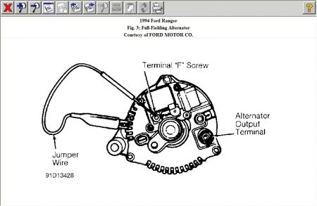

Yes I did the jumper test without using the key. It will start and run for a minute but the starter will not kick back and it is the correct sterter. I t is for a 4cyl, 5 spd. 2.3L. I still do not understand why the alt. Will not charge. I tested the two connectors on the side of the alt. And one wire shows the light bright and the other shows a dim light, the middle wire has nothing. The starter will start the truck but if I don't remove the negative terminal it will burn up another starter. Ignition switch is good, solenoid or starter relay is new, starter is new, battery is new, alternator working fine until you crank and start the truck, then the starter sticks. Touching the starter realy makes it kick back but still no charging. Could it be the connections on my alternator. How can I test besides voltmeter showing good and light test showing good. Have tried evreything and using Haynes is not helping. Where is my computer located on this Ranger? Thanks for any answers in advance.

Charging system -Do below full field the alty while engine is idling-Is it charging now if so replace the regulator. Get back
https://www.2carpros.com/forum/automotive_pictures/12900_alty_25.jpg
