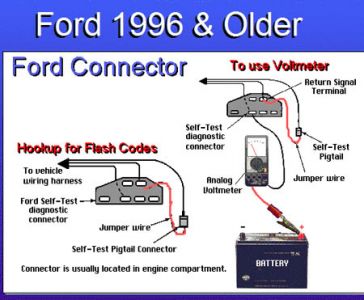

Start with the basics, and work your way up, Last tune up was? Wires plugs ALL filters? If all that is ok, check for a stuck EGR, then test fuel pump pressure, If it won't restart, determine what's missing, the engine needs three things to run, Spark at all plugs, gas to all cylinders, and compression in all cylinders, tho an engine may run lacking one in one cylinder, it won't run very well! Is your check engine light on? Read the codes...
http://www.2carpros.com/forum/automotive_pictures/62217_Test_Connector_Pre96_2.jpg
Count the sweeps or the flashes on the dash light. write all codes down. Post results...
