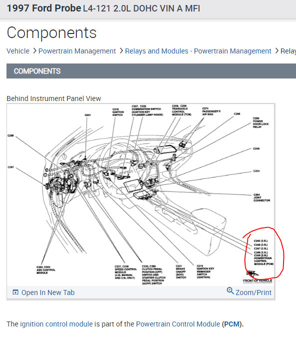

I know this is many years old, did you guys ever find ICM? Factory service manual states it’s part of the PCM. But I have a coil and be a distributor.
Monday, September 6th, 2021 AT 5:24 PM
SQM
  • 6,383 POSTS
Yes the ignition control module (ICM) is part of the powertrain control module (PCM) and cannot be serviced separately. The PCM is located under the dash on the center.
