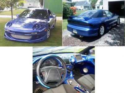

Hello man im having the same problem as sara i pressure washed my motor not hard just a quick wash over not directly on the motor just over it it wasnt running or nothing then after that i waiting like 5 mins and i started it up it started right up and then after a min or so it started spitting and sputtering and backfiring and then died and it had no spark after that i changed the crank sensor and everything distributor wiring harness under the hood new computer (even tried the old one also) new ignition still nothing it gets fuel an everything checked the grounds they were fine i checked my timing belt its tight but still could it be out of time even if the belt is tight? if its out of time will it still not fire please help me!! also heres pictures of my car :]
