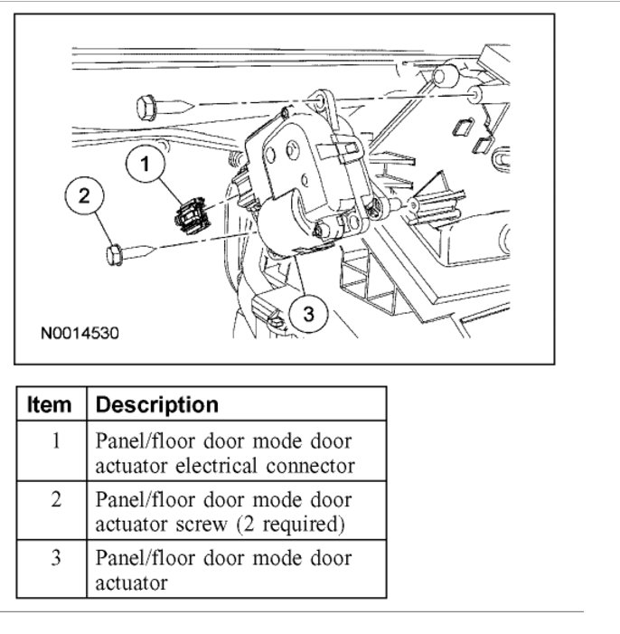

My air vents on the dashboard just stopped working. The foot vents blow,the defrost vents blow,the foot and defrost vents blow but when I turn the switch to blow on my face nothing comes out. The fan is blowing still on my feet. This is the same when A/C or heat is on. Yesterday it was working fine

It sounds like you have a blend door actuator that has gone out that controls the mode. Here is a guide the give you an idea of what you are in for when doing the repair.
Here are some diagrams (below) of what it like on your car.
