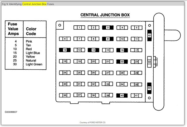

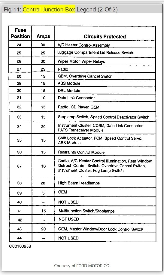

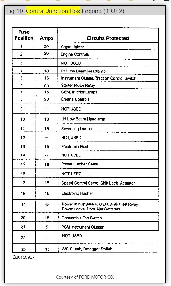

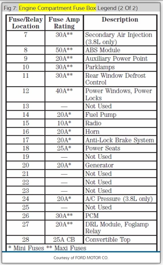

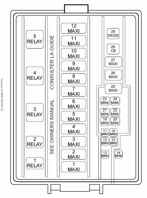

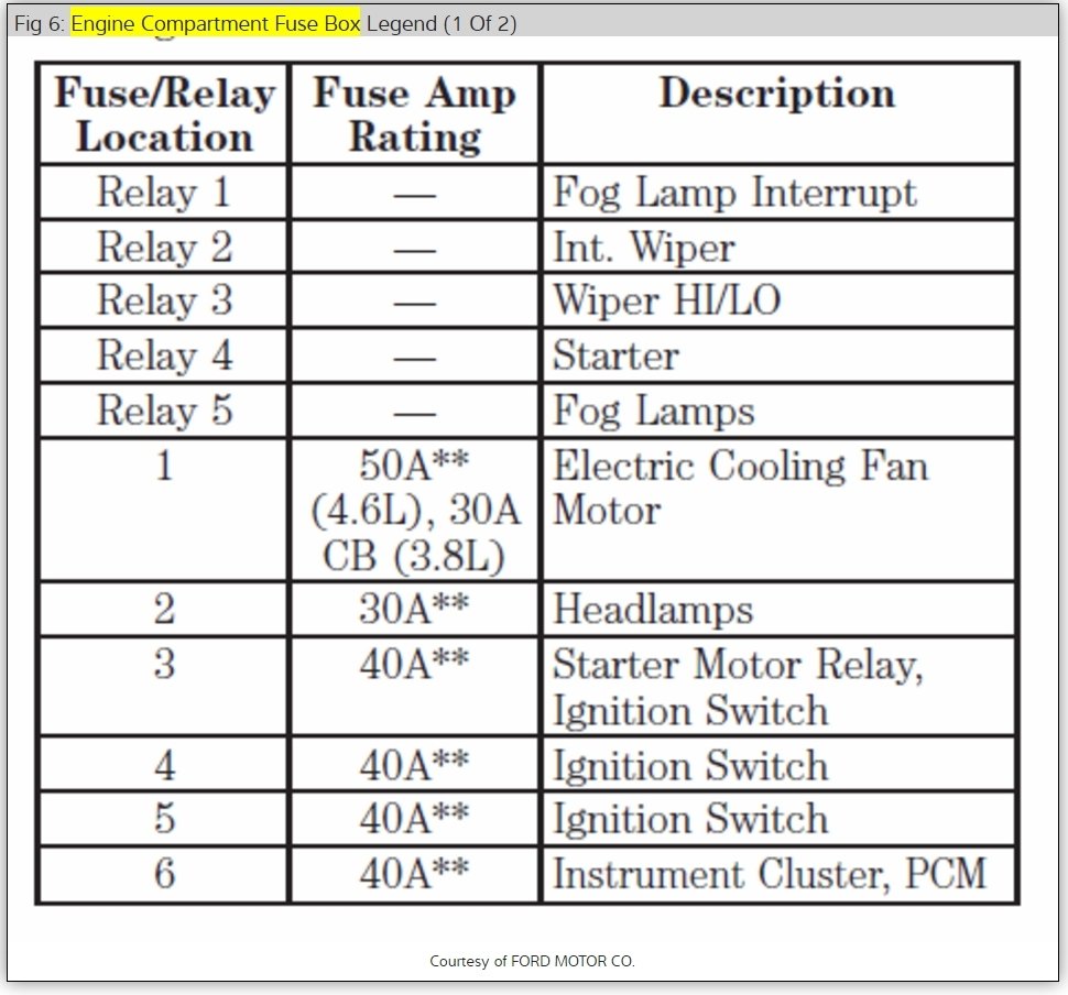

Both the cigarette lighter (dash) and the power outlet (console) do not work. Neither has voltage to the receptacle. Can someone send me the layout of the fuse box? It is under the dash and would take a contortionist to remove and examine them all.
Thanks,
John
Mar 16, 2009 at 4:06 PM
  • CAR REPAIR CONTRIBUTOR
  • 54,328 POSTS
Hey John,
There are two fuse panels one under the hood and the other inside the car. Here are all of the images and legends for both.
Here is a guide to help you check them and the fuse panel diagrams are BELOW
Please run some tests and get back to us so we can continue helping you.
