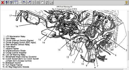

When I attempt to signal left or right, the lights light up but do not flash. When I turn on the hazard lights all the lights that are supposed to flash do. I do not know what the problem is.

Test the turn signal flasher or replace it-see below for location-Good Luck
https://www.2carpros.com/forum/automotive_pictures/12900_turn_flasher_1.jpg

So I m guessing from the diagram that the turn signal flasher is not located on the actual fuse panel with the hazard light flasher?

The hazard flasher is located at item no.7 in the diagram
