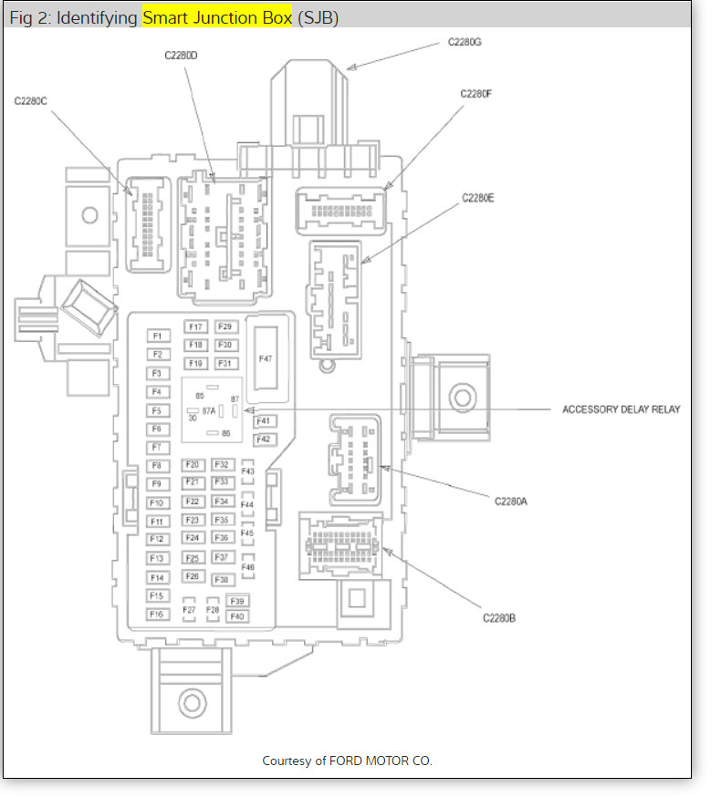

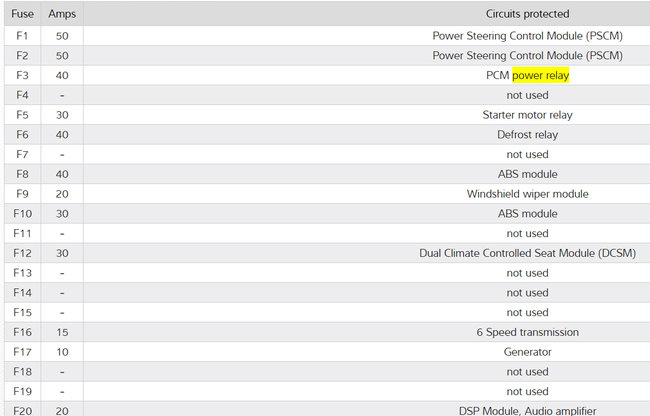

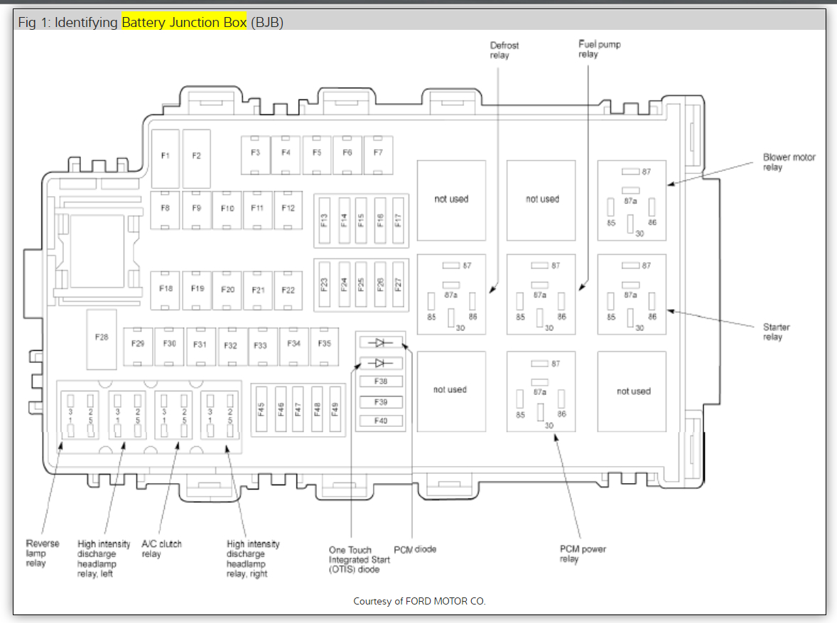

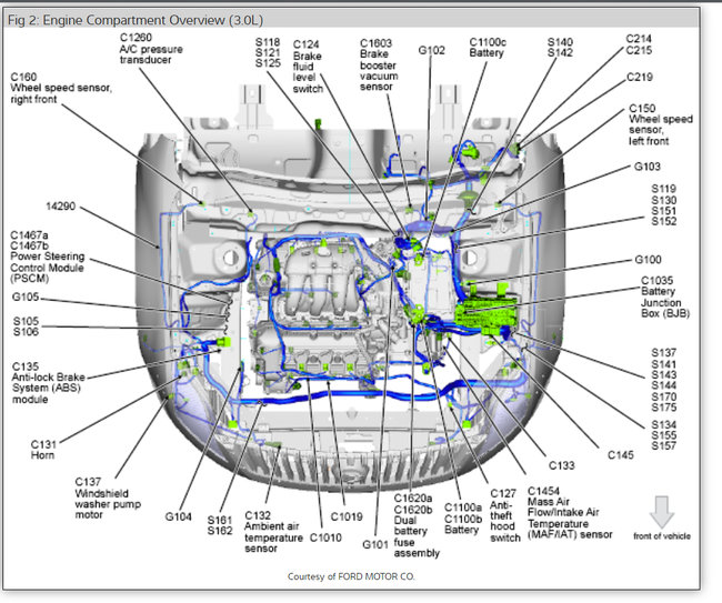

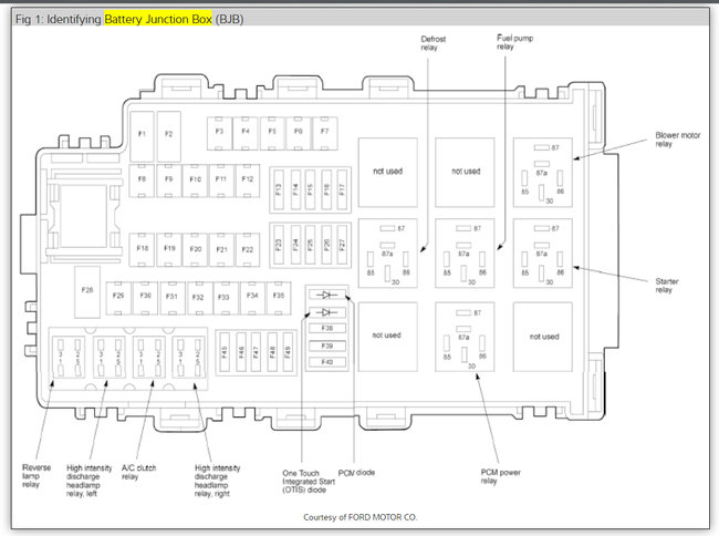

Hi. My cars ac clutch in not kicking in.I and my dad have checked the fuses,freon charge,and relays. They are all good. We was going to check the Low Pressure Relay,but was not sure how it is wired. Any help you can give us is much welcomed. Thank You very much. Will this Low Pressure Relay keep the ac clutch from kicking in? T Y Jeff.

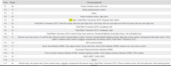

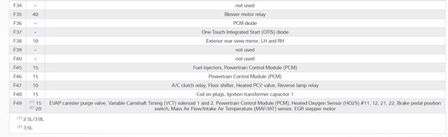

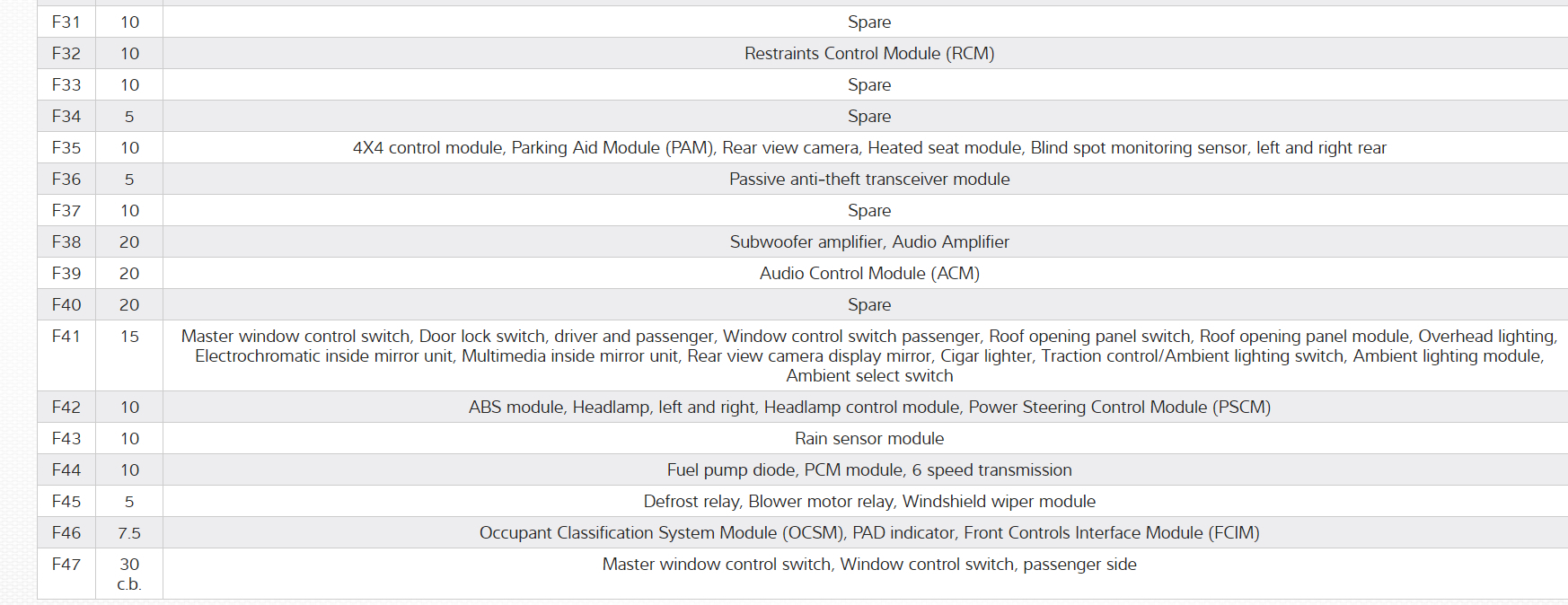

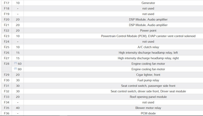

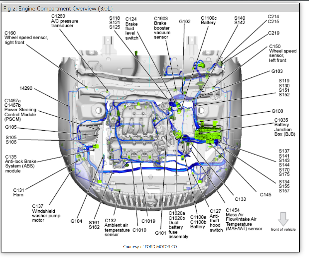

The compressor relay is located under the hood in the PCD here is a guide to help you test he relay once you have found it from these diagrams below.
Cheers
