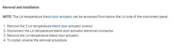

DAVE H
  • 13,384 POSTS

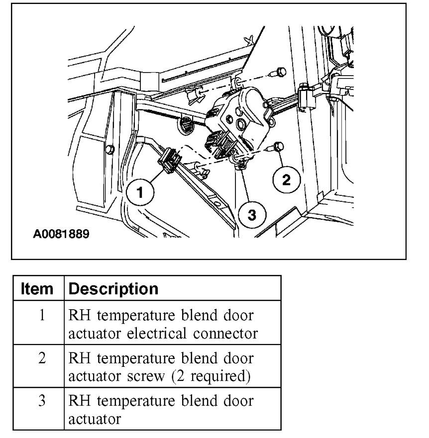

You would need the body codes to find the correct pinpoint test for that particular circuit. They are a common problem, usually you can see the motor spindle turn if it is working.
The instructions for replacement of both RH and LH are attached below
+1

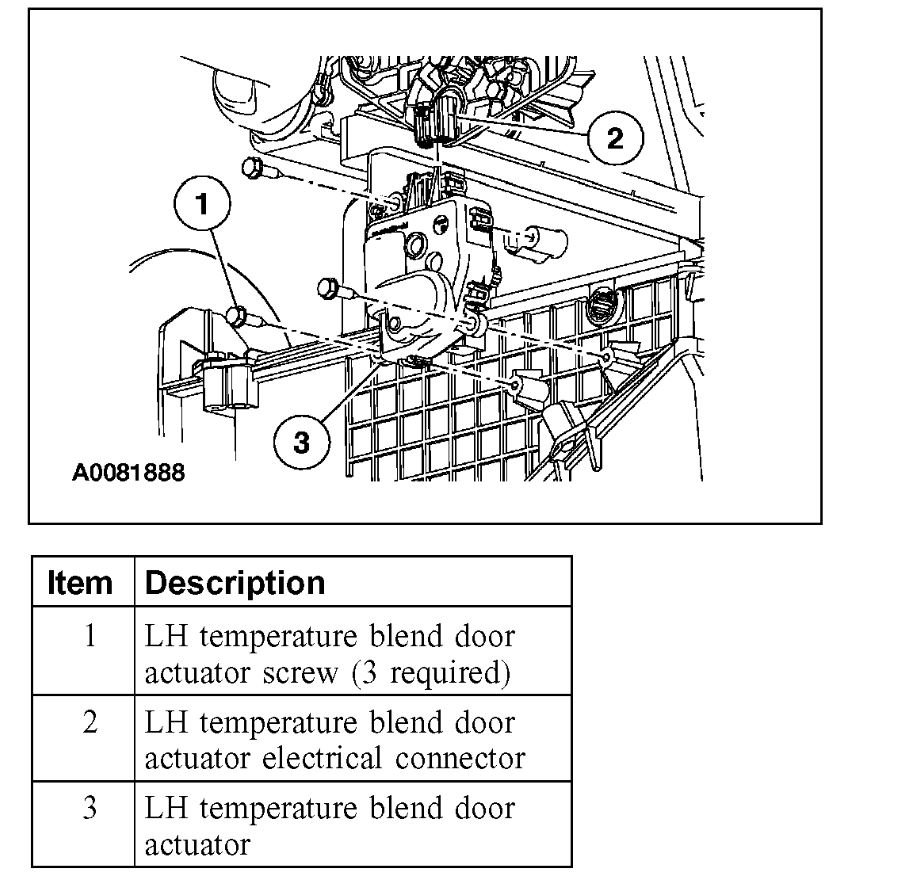

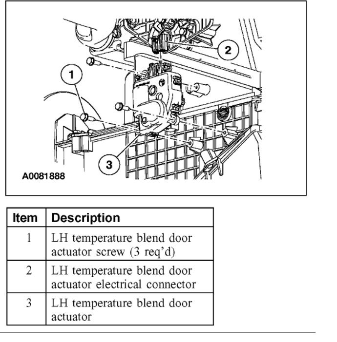

I think I know what it is but not to sure. Do not want to buy something if I do not have to. I think I need a blend door actuator. For the driver side. My problem is, it gets some what colder when you driver down the road. But when you stop it gets warm. If it is not the blend door actuator what is it, and how do you do it? Also, what is the part number? They have so many kinds in this van.
Saturday, November 3rd, 2018 AT 8:21 AM (Merged)
KEN L
  • MASTER CERTIFIED MECHANIC
  • 55,350 POSTS
Yes you are right, it sounds like the blend door actuator is bad and and needs replacement. Here is a guide and some diagrams (below) of what you are in for when changing the actuator.
+1

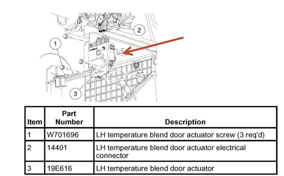

Are left and right heater blend door actuators identical, and if so what is the part number?
Saturday, November 3rd, 2018 AT 8:22 AM (Merged)
No, they are different.
You can call the dealer for the part numbers.
