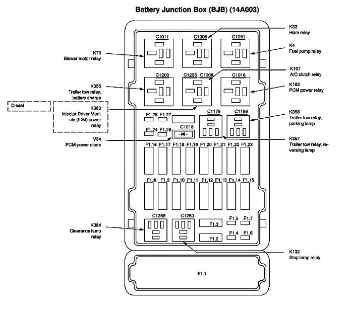

I checked the oil level and found it was about 2 quarts low so I added oil. It still wouldn't run. I had it towed home and put it on a battery charger. Both batteries read 12.5 volts. I then replaced the Cam Position Sensor. None of this helped. It fires right up but will not run. Help!

I turn the key and wait for the glow plug light on the dash to go off. As soon as it goes out, I turn the key and the truck starts. It runs for about 5 seconds and then dies. Even if I put the pedal to the floor or pump the pedal, the truck only runs for about 5 seconds. If I turn the key off and then try to start the truck again, it starts right up and only runs for about 5 seconds again. So I replaced the glow plug relay and that seemed to fix it. Thanks for your help.
