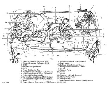

My 7.3 diesel will start, and run about 5- 10 min. Then dies like someone turned the key off. If I wait a couple of min. And start it again, it will run only about 1 min. And stop again. I changed the fuel filter and oil. No help.

Replace the fuel pump, and water seperator.
https://www.2carpros.com/forum/automotive_pictures/108325_diesel_1.jpg
Other possibilities are the Injection pressure regulator, fuel heater, Injection control pressure sensor.
Other than the pump and water seperator, you may have to visit the Ford dealer
