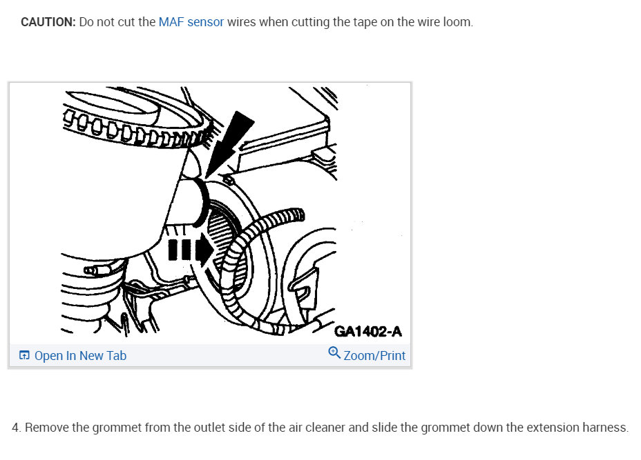

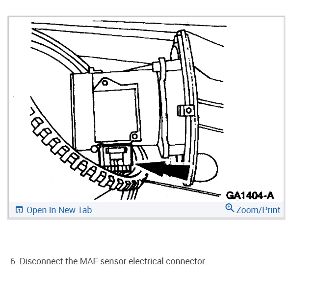

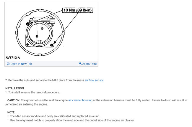

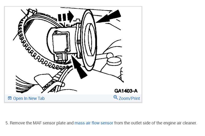

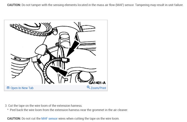

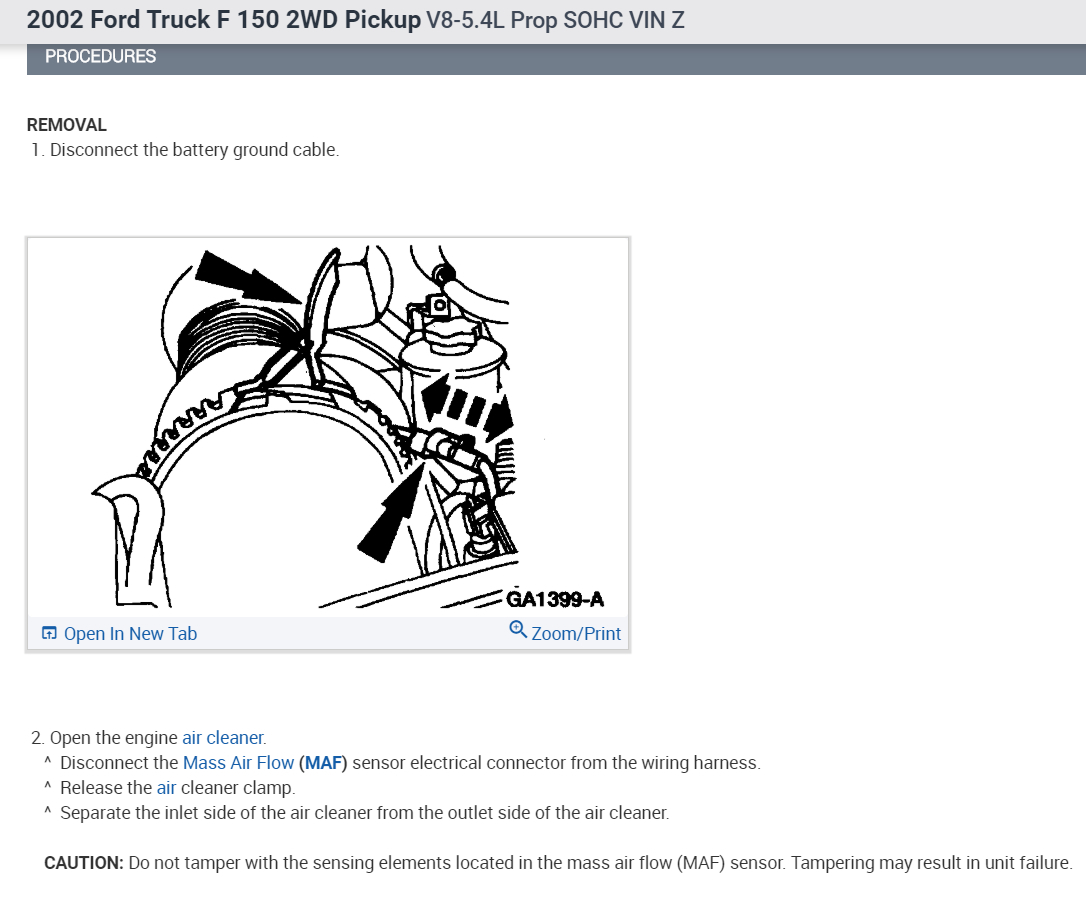

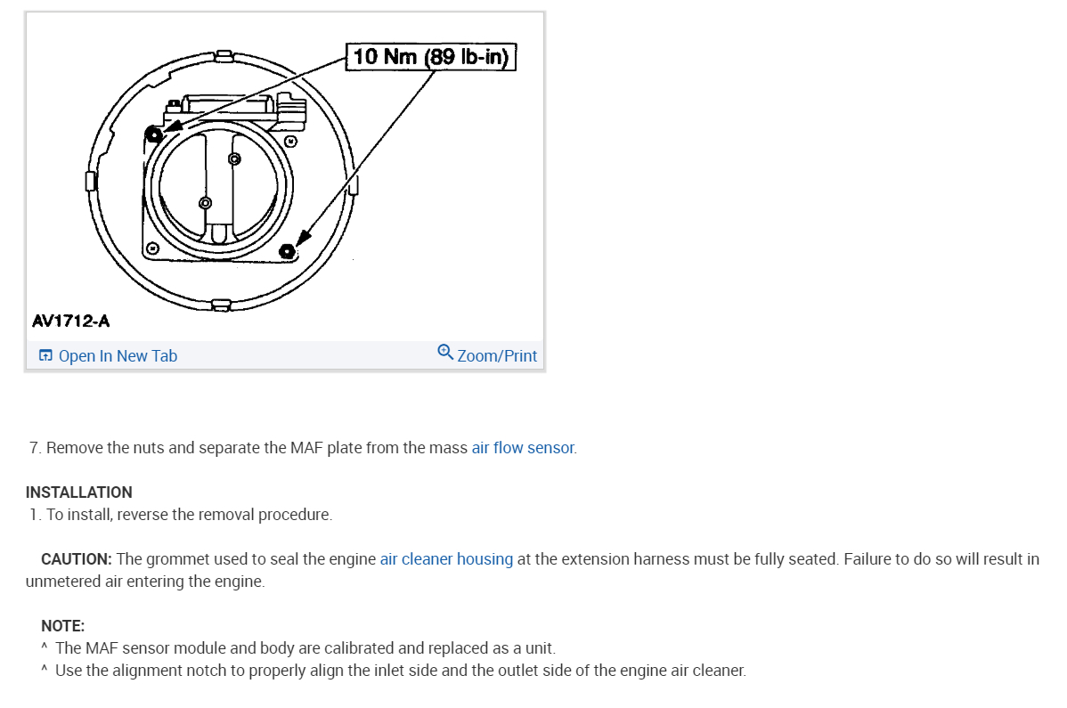

KEN L
  • MASTER CERTIFIED MECHANIC
  • 55,470 POSTS
If I can help out. I have seen the MAF sensor go bad causing this issue which will cause the O2 issue as well. I would replace the sensor with a new unit these are normal service items. Here is a guide to help walk you through the steps with instructions in the diagrams below to show you on your car:
https://www.2carpros.com/articles/how-to-replace-a-mass-air-flow-sensor-maf
Mass Air Flow Sensor - YC2Z12B579BARM $264.51
Thursday, September 3rd, 2020 AT 2:21 PM (Merged)
