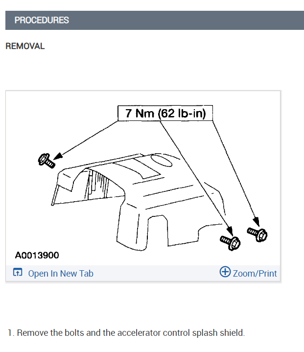

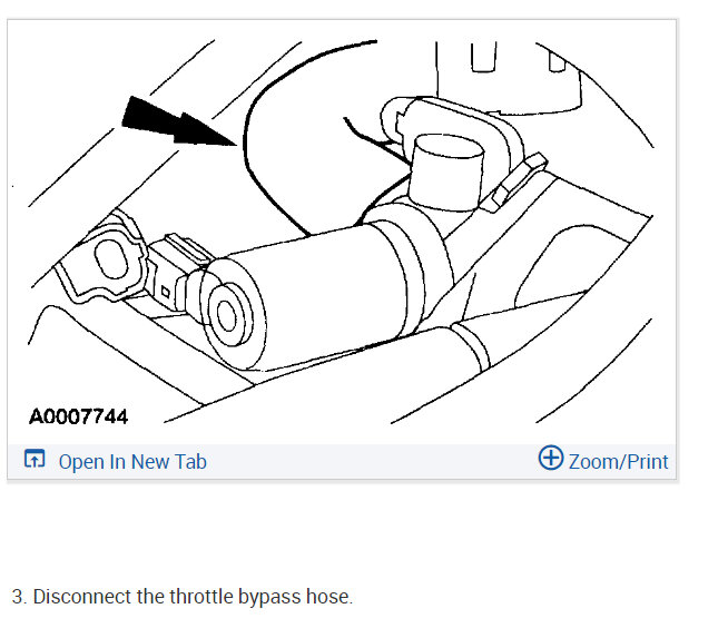

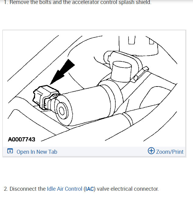

To me it sounds like the throttle body needs to be serviced along with the IAC valve needs to be replaced. Here is the location of the IAC so you can change it out and a guide that will help you as well.
this guide can help as well
I have also seen the idle air control valve hose go bad and create a vacuum leak so I would check that as well. Check out the images (below). Please let us know what happens.
