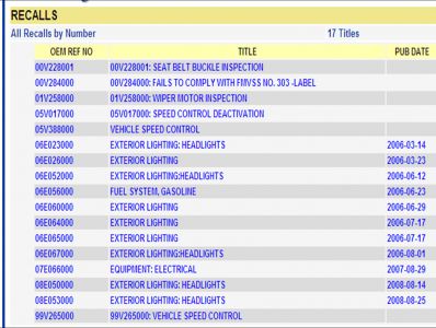

I did do a quick review of about 220 TSBs. Many have DTC numbers but I would need to know if your truck threw any of those codes.
I did find 3 that talked about the oil system. . .. . .. . ..but I don't think any apply. Here they are for your review though.

Last, it looks like you may have some recalls on your vehicle. The dealer may fix these for free. Please contact the dealer service department, give them the VIN number of your car and have them check on these to see if they apply to you.
https://www.2carpros.com/forum/automotive_pictures/248015_Recalls_4.jpg
