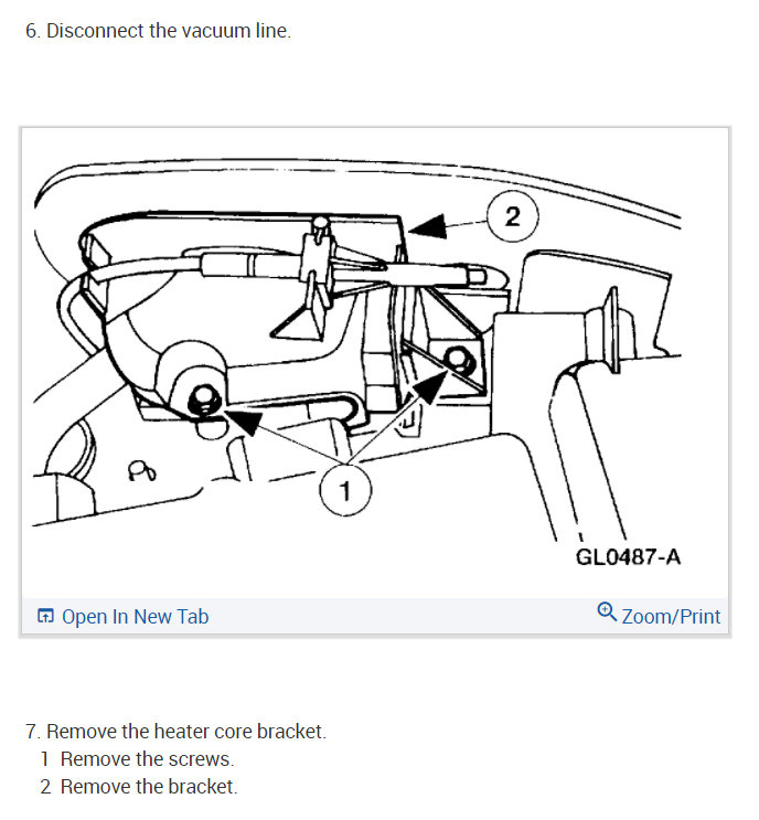

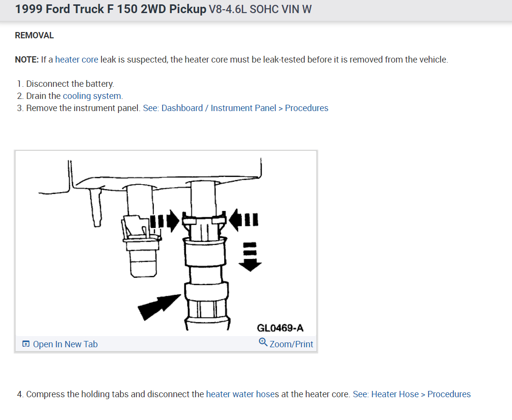

How hard is it and how long to change out a heater core?
Jun 19, 2008 at 4:38 PM
BMRFIXIT
  • CAR REPAIR CONTRIBUTOR
  • 19,053 POSTS

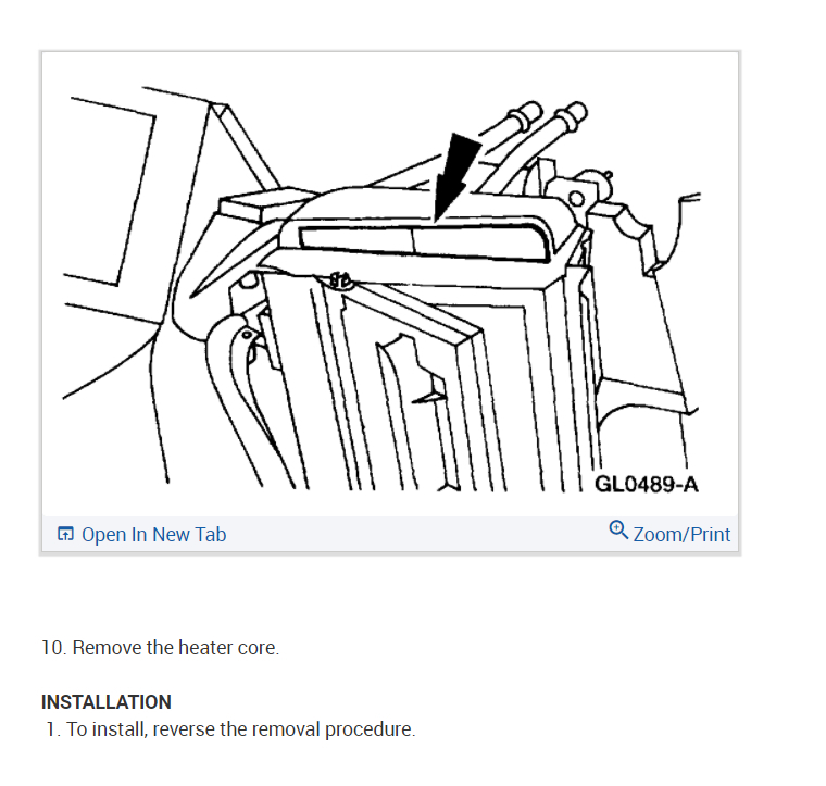

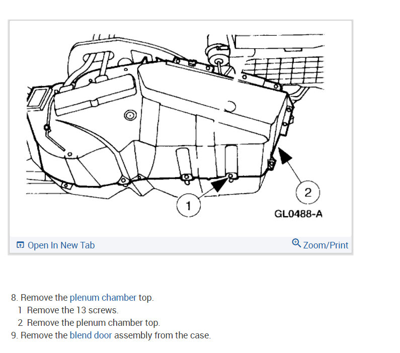

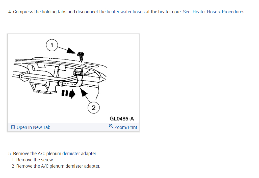

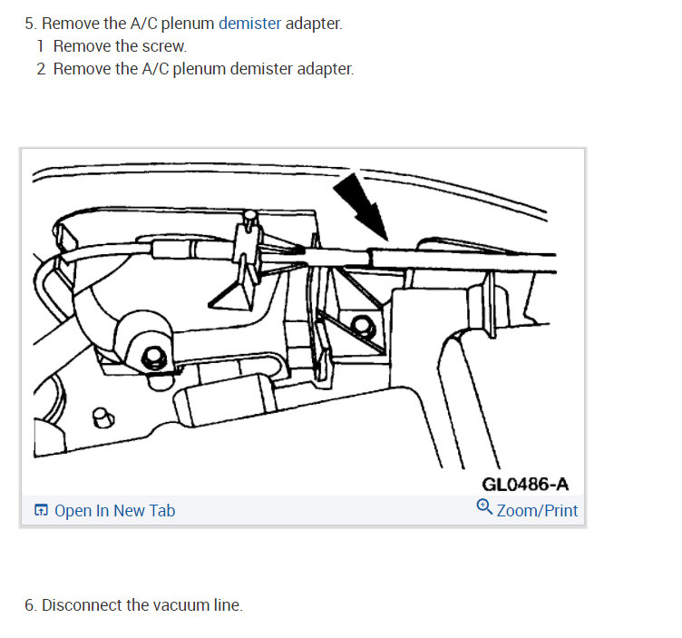

Its a good 7 to 8 hr of labor you need to remove everything in front of you all the way to the heater box. This guide will help walk you through the repair with instructions in the diagrams below to show you hoe on your truck.
https://www.2carpros.com/articles/replace-heater-core
if your truck has AC you will need to vacuum down and recharge the system this video will show you how.
https://youtu.be/4EqdrBVb0sY
