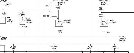

I'd have to check the feed to and from the brake switch. The feed from the brake switch goes through the multifunction switch.

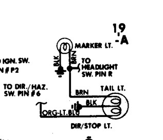

Did you check applicable fuses? Use a voltage tester. At the rear, the brown wire is voltage for tail lamps, goes hot when you turn on the headlamp switch. Black wire is ground. The other wire is voltage for stop and turn, they use the same bulb filament, just not at the same time.

My first thought is the multifunction switch has a problem. You can also check for voltage and ground at the rear.

The diagram should be for left rear. Brown wire is voltage for tail lamps, black is ground.
