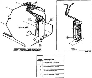

1996 Ford F-150 truck not getting fuel, wont start
JEANNIE LANESE
  • 1996 FORD F-150
  • 6 CYL
  • 2WD
  • 12,500 MILES
Possible fuel pump problem? Where is fuel pump located? Any suggestions appreciated. Thank you.
Saturday, July 17th, 2010 AT 5:43 PM
2 Replies
  • 75,992 POSTS

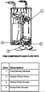

Check the fuel pressure to rule out the fuel filter/fuel pump/pressure regulator and listen to the injector/s are they pulsing or hook up a noid light.
Fuel Pump
http://www.2carpros.com/forum/automotive_pictures/12900_fp_53.jpg
http://www.2carpros.com/forum/automotive_pictures/12900_fp1_34.jpg
