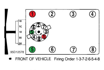

BMRFIXIT
  • 19,053 POSTS
This is what i have good luck
https://www.2carpros.com/forum/automotive_pictures/99387_f150_firing_1.jpg
