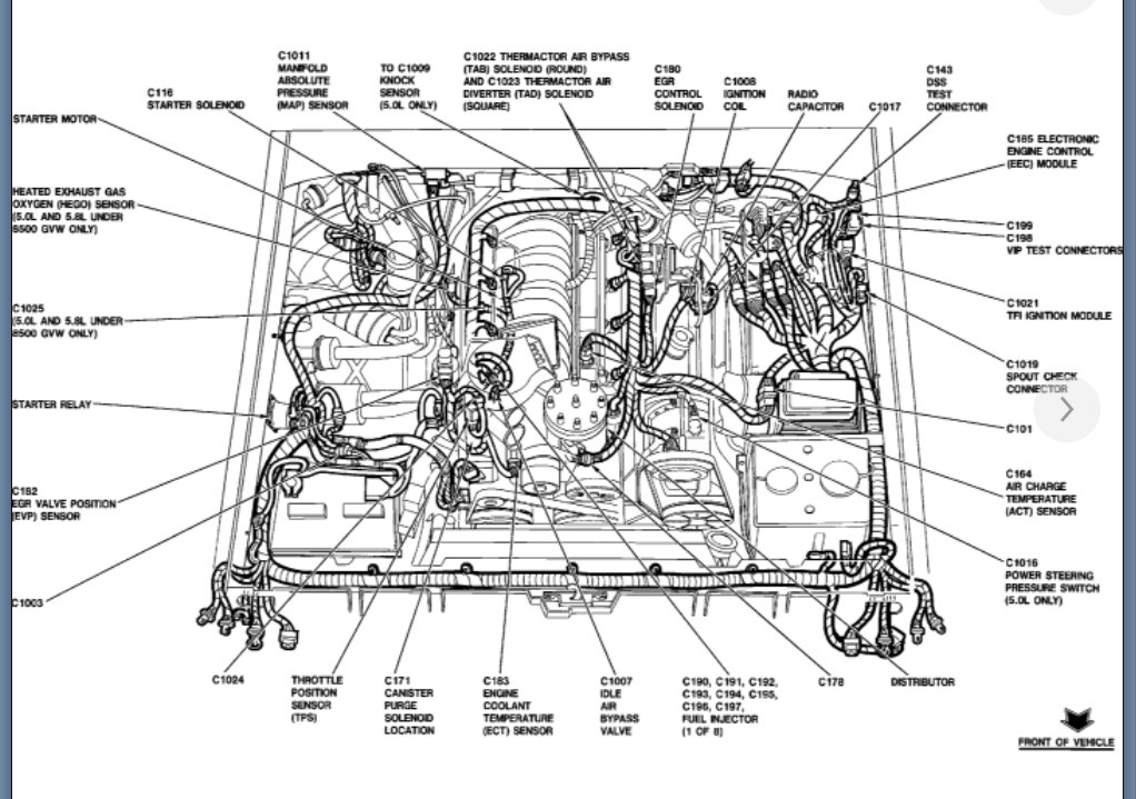

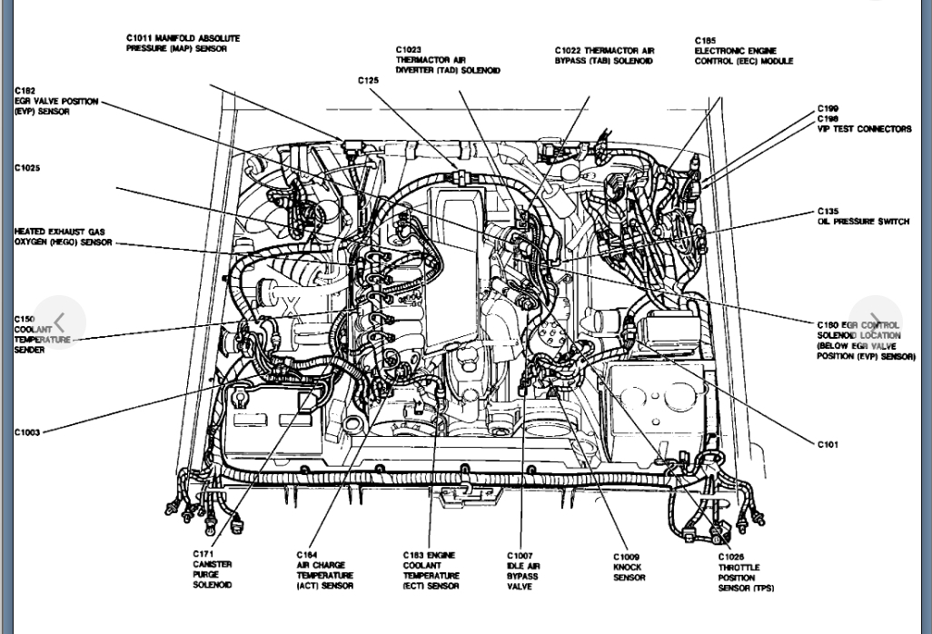

I think we may have found the Issue. The early 1990's Ford truck put the PCM in a bad location (through the firewall under the brake booster) allowing it to be venerable to water. We removed the computer to find it extremely rusted and it looks as though it had sat in a puddle of water. We are going to go ahead and swap it out just to cover that portion.
May 21, 2022 at 6:00 AM
  • CAR REPAIR CONTRIBUTOR
Thank you so much. That is great info. I am attaching the location of this module for those that may need it. It is where you talked about and is actually called the EECM.
Thanks for coming back and updating us.
