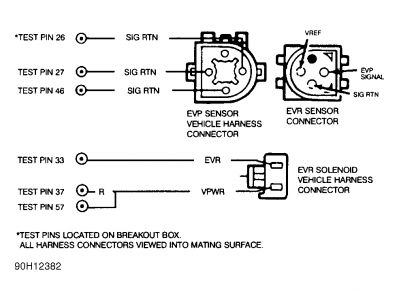

My check engine light comes on about five minutes after I start my truck. I have ran a code scan on my truck with a Actron code scanner and have gotten with the KOEO codes of 83 and 84 and the code have to do with EGR control solenoid and EGR Shut off solenoid circuit failure. I have replaced the EGR solenoid. My engine light still comes on and get the same scan codes after I have replaced the EGR solenoid. Can you please help??

Ok which solenoid did you replace? Where was it located? Was it on the egr valve the position sensor or was it on the intake where the vacuum lines and electric plug to to? Let me know so I get you the test to the other componants ok. Thanks

The solenoid was by the intake manifold and has two vacume lines attached to it and an electrical plug with two wires that plug into the solenoid component.

Ok first here is a chart with the pins and there numbers as you need a digital multi meter and the we will check to see why the egr system is having faults. Here is the chart. so you can print it.
https://images.2carpros.com/forum/automotive_pictures/249564_evp_1.jpg
FIrst unplug the solenoid so you can test pin 57. Set your multi meter on 20 volt scale and put positive side on pin 57 and neg. to good ground and turn on key and read voltage. If less then 10 volts then you need to find the bad part in that wire section and fix it. If more then you need to test resistance of pin 33 and ground on the 200 ohm scale if more then 5 ohms then there is a break in that circuit. Let me know what this brings ok.

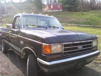

I have a 1990 f150 with a 300 inline 6 i had it for about 2 weeks now and it doesnt seem to be getting as much power as i should. Im going up a hill and its maxing out at 45 mph. The check engine light came on so i took it to get tested and it said the computer isn't responding with the scanner. It also has one bad fuel pump. I was wondering if this is just how fast the truck will go or could it be the computer or maybe another bad fuel pump. Any ideas will be helpful. Thanks bill
https://images.2carpros.com/forum/automotive_pictures/509408_AAA_1.jpg

Hi, thanks for the donation, nice looking truck. Whoever tried to check for codes, may be correct, but, I'd have to double check. You can check for possible codes, yourself. There should be two connectors, underhood driverside, fender. The info below shows two different ways, you can access codes, if possible. The top part, uses a jumper wire and analog multimeter, you count the needle swings in order to get the some codes. The bottom way, just uses a jumper wire, then the mil on the dash starts flashing, you count the flashes to get the codes. How long since a tune-up. Check fuel pressure.
https://images.2carpros.com/forum/automotive_pictures/170934_ford_f150_1.jpg

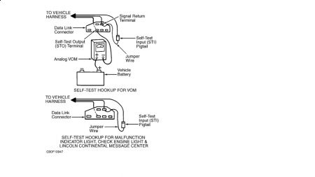

how do i remove the codes on my truck without a scanner
Sep 10, 2020 at 10:42 AM (Merged)
BLACKOP555
  • CAR REPAIR CONTRIBUTOR
  • 10,386 POSTS
ground out the dlc connector terminal b to a good engine ground and put a jump wire from the sti to the dlc. turn key on.

Hello, I'm Danny.
Are you using an OBD1 scan tool or jumper wire in the diagnostic port? Here is a tutorial for you to view for Ford OBD1 codes:
https://www.2carpros.com/articles/ford-lincoln-mercury-obd1-1995-and-earlier-diagnostic-trouble-code-definition-and-retrieval
Hope this helps and thanks for using 2CarPros.
JAMIEYOUNG
I'm using a jumper wire and the check light just stays on, it doesn't flash. why?
  • 54,350 POSTS
The check engine light wont flash, the test light will connected to the diagnostic connector please go over the guide above again and get back to us.

ANTI-LOCK BRAKE SYSTEM -1988 Ford Pickup F150
Page 1 of 1
RETRIEVING CODES
Tips Click a link to view tip
Tip: ABS CONNECTOR - 1987 F150
Tech1
To obtain stored trouble code, momentarily ground diagnostic connector and record number of times light flashes. See Fig. 2 . DO NOT turn ignition off before grounding connector or code will be lost.
Only the first code stored will appear until that problem is corrected.
Fig. 2: Diagnostic Connector Location (Bronco II) Courtesy of FORD MOTOR CO.
Fig. 3: Diagnostic Connector Location (1987 F-Series Pickup & Bronco) Courtesy of FORD MOTOR CO.
Fig. 4: Diagnostic Connector Location (1988 F-Series Pickup & Bronco) Courtesy of FORD MOTOR CO.
NOTE:
The test connector is usually located behind left door pillar panel.
© 2008 Mitchell Repair Information Co., LLC.
