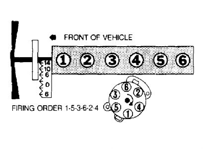

I would like the order of fireing
Sunday, February 10th, 2008 AT 7:54 PM
BMRFIXIT
MECHANIC
19,053 POSTS
Here what i have
let me know
