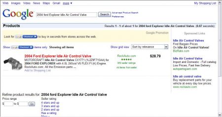

This is our first FORD and we have no idea where the iac is. Can you send me an engine picture so we can locate it. Someone said it was on top of the TB, but there is nothing on the top, only on the side. This is a 04 Explorer 4L V6 XLS and I have only had this vehicle of a month, I just bought it. Factory warrenty was up in April so if I take it in, this may cost me more than my payments. Hell I haven't even made my first payment. You really gotta help me here. :(

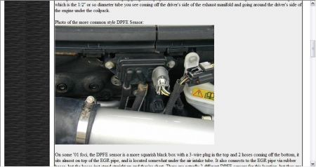

One more thing, what is a DPFE?

The IACV will look like this below and it will be somewhere within the throttle body-
https://www.2carpros.com/forum/automotive_pictures/12900_2004_Ford_Explorer_IACV_1.jpg
The DPFE is the pressure feedback it will look like this
https://www.2carpros.com/forum/automotive_pictures/12900_DPFE_2004_Ford_Explorer_1.jpg
