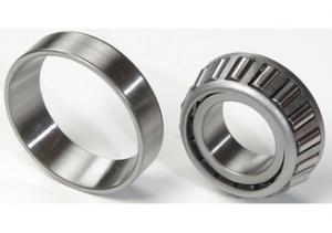

I just took my 1993 4.0l 4x4 explorer in for a safety and wus told that I needed to change the front wheel bearings. They told me that this was a complete hub assembly that I would have to change. In my calling around and found only wheel bearings, no hubs to change. Is this accurate or am I missing something? Thanks for any help

I show older style indidual bearings, not hub assy!
http://www.2carpros.com/forum/automotive_pictures/62217_getimage_1.jpg
However, you will need to take the locking hubs apart to get to em...
